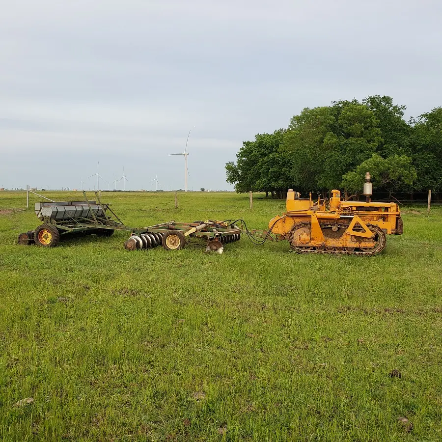

i was considering purchasing a disk that would fit a D5 maybe so i could get more done. same for the D4d. the only equipment i have right now fit the old D46U pretty well but i would like to size up some. right now just shopping and trying to learn the ins and outs of AG CAT's. from my limited experience with the D46U i wonder why i haven't done this many years ago. all of my land lays together with only 1 mile between two different properties so getting moved shouldn't be an issue.

 [attachment=64099]20200516_194100  234.jpg[/attachment]
Sat, Jul 17, 2021 6:53 AM
bursitis
Location: Oklahoma
Posts: 1,085
Reply to bursitis:
here is a pic of the D46U set up
