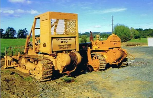

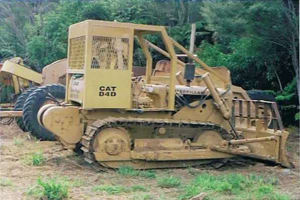

[attachment=10392]Michael.JPG[/attachment]some more[attachment=10391]Rolling 2.jpg[/attachment]
Here in the States we call it "the Snowball effect". Once the snowball starts rolling it just becomes bigger & bigger. We all know how it starts. "Well as long as I'm this far, may as well do that too".πŸ˜† The trick is knowing when to stop (with me it's when my wallet's empty. I've already worn holes through two leather wallets with my D2).
