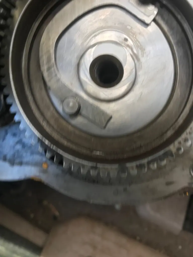

D4d compact injection pump spring. Is the picture correct?

 [attachment=77956]IMG_0121.jpeg[/attachment]

Yes, that is correct. It is a combination of drive and torsion dampner for the injection pump. If those parts show wear or slop you will get irregular engine rpm's.
I couldn’t tell by looking at the service manual if the spring needed to go the other way around. Thanks for confirming my guess.
