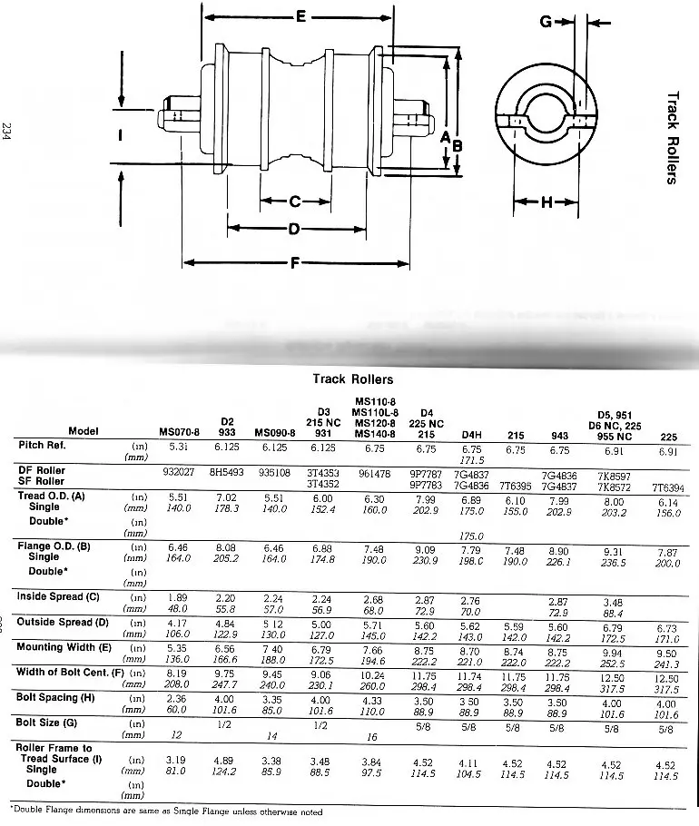

Someone local to me is advertising near new D4D bottom rollers, is there any chance I could use them on my D4 7J and RD4, or are they a larger chain and mounting bolt spacing on the track frame?

Hi Mike,
this is about all I have to help you with from the Undercarriage Conversion Guide, 1988.
Hope this helps.

You are amazing Eddy, how fast you find these technical sheets, scan them, and post them, we sure are lucky to have you keeping an eye out for us. I'll get my old Part Number books out and do a search on the Machinery Trader site, see if those newer Part Numbers cross check back to the older D4.

I just checked part numbers on the Machinery Trader site, and the D4 6U has the same P/N's as that chart 9P7787, correct me if I'm wrong but the D4 6U has the same undercarriage specs as the older D4 7J and RD4 doesn't it? Like 6U bottom rollers will bolt onto a 7J and 2T?

If I can believe my old interchange catalog, all the D4's use the same roller mount dimensions. I know it's good back to the 7J, 2T but I'd still take the measuring stick to the RD4's.
Hi Mike,
as OM said, measure ALL the roller dimensions on your machine and compare them to the chart sizes before doing anything else. I posted the chart so you could do a comparison of the chart versus your machine.
Sorry, I maybe should have said that in my first post.
