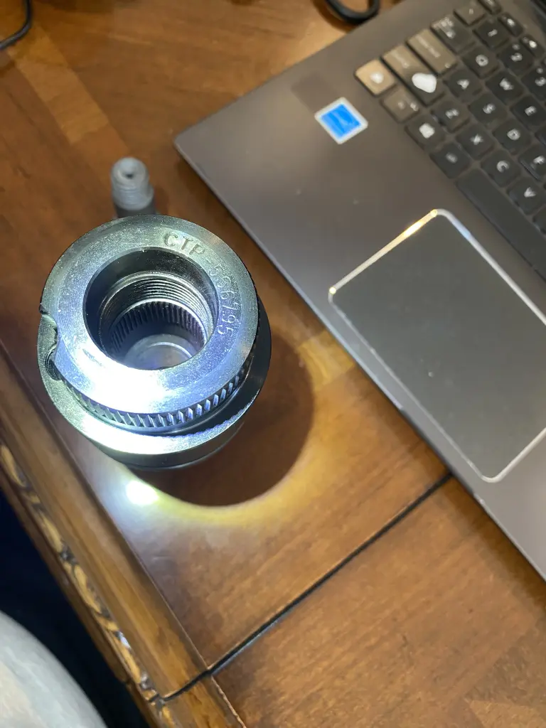

Hi Folks,
I wanted to replace my injectors and chanbers and I'm not sure I have the correct items. Chamber is 5S6795 and the injector body is 8S2389. judging from the photo unless the nut is special I don't see how the injector fits in the screw chamber. Any advice would be welcome.
Cat-Bruce

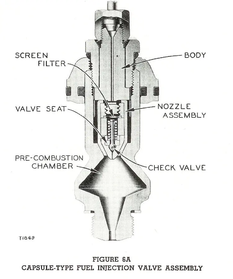

Hi,
this pic may help show how these capsule nozzle injectors are fitted--torque for the capsule nozzle nut is 100 lb/ft.
Only tighten the nozzle to the body finger tight--the torque applied to the retaining nut causes the seal between these components, the nozzle opening pressure is around 600psi so a leak here is unlikely unless debris or rust pits etc. are on said faces.

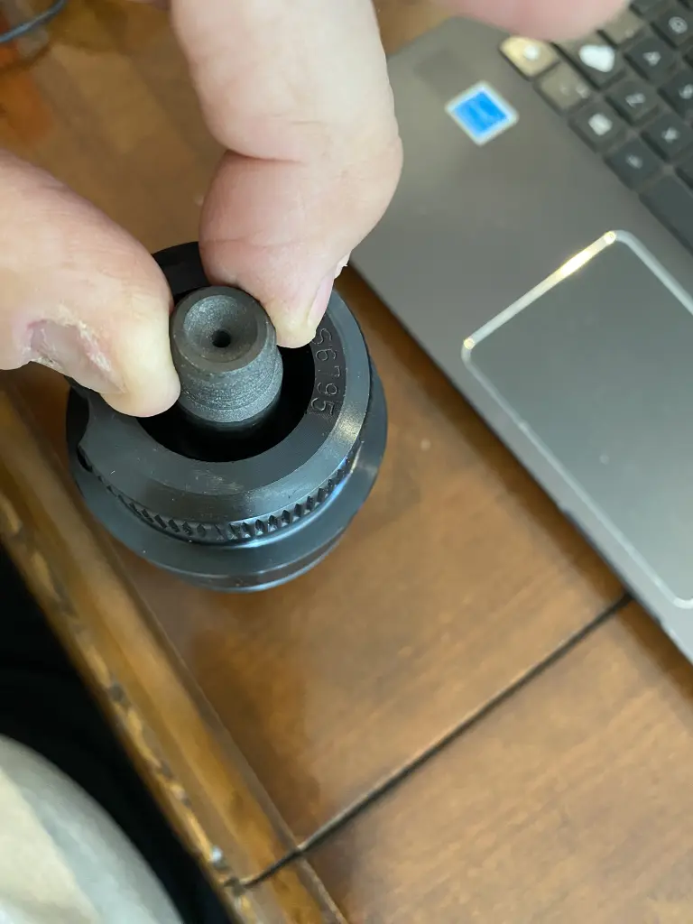

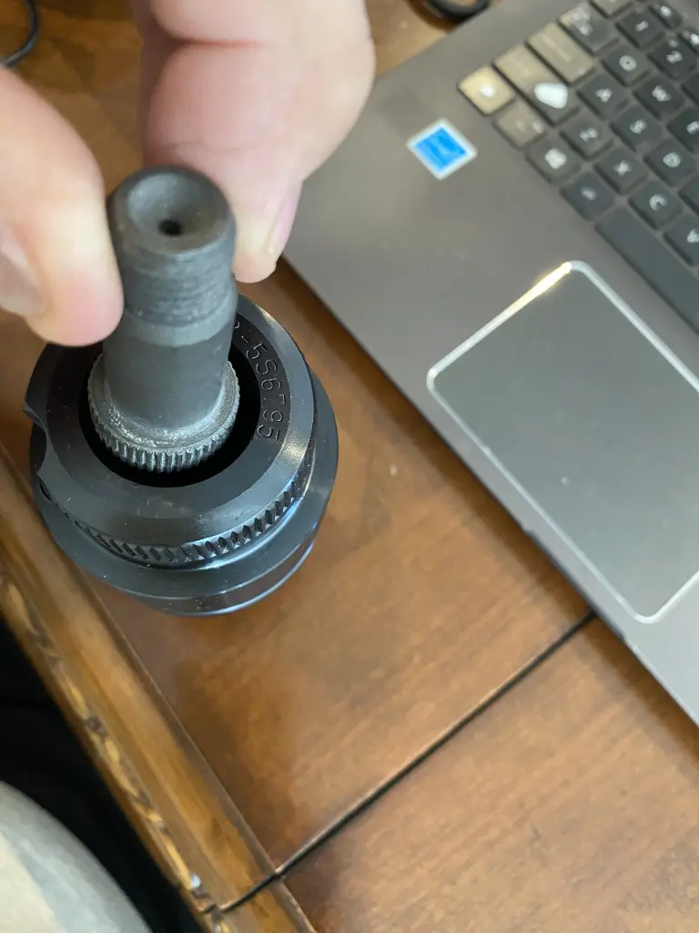

Wow thanks Eddie. I had the injector backwards. Here are the pictures.
