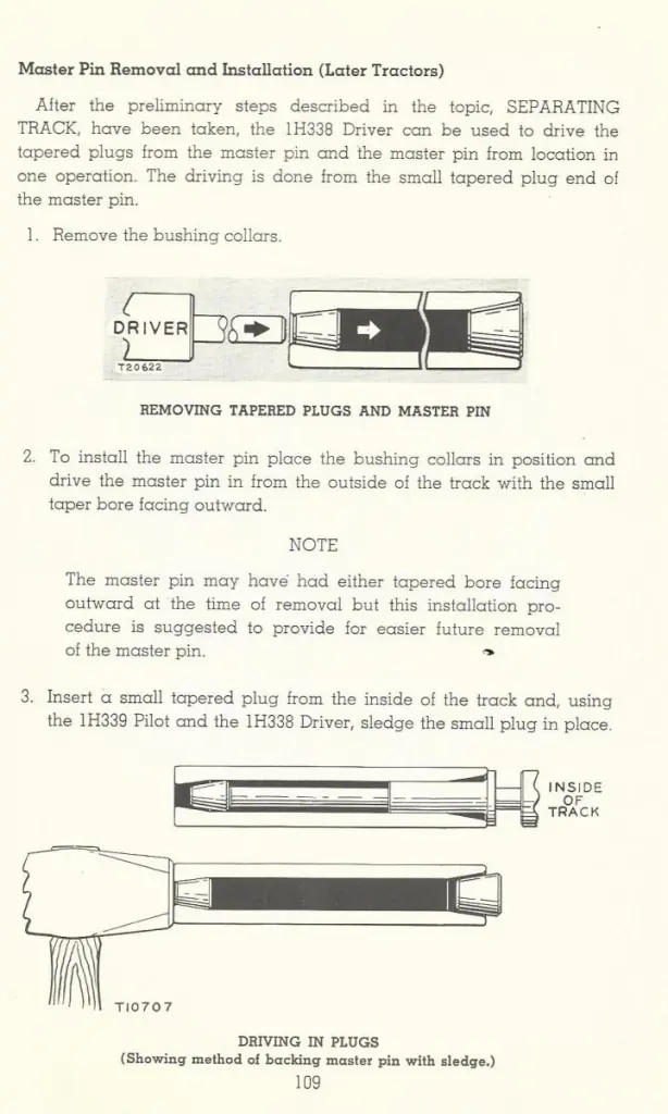

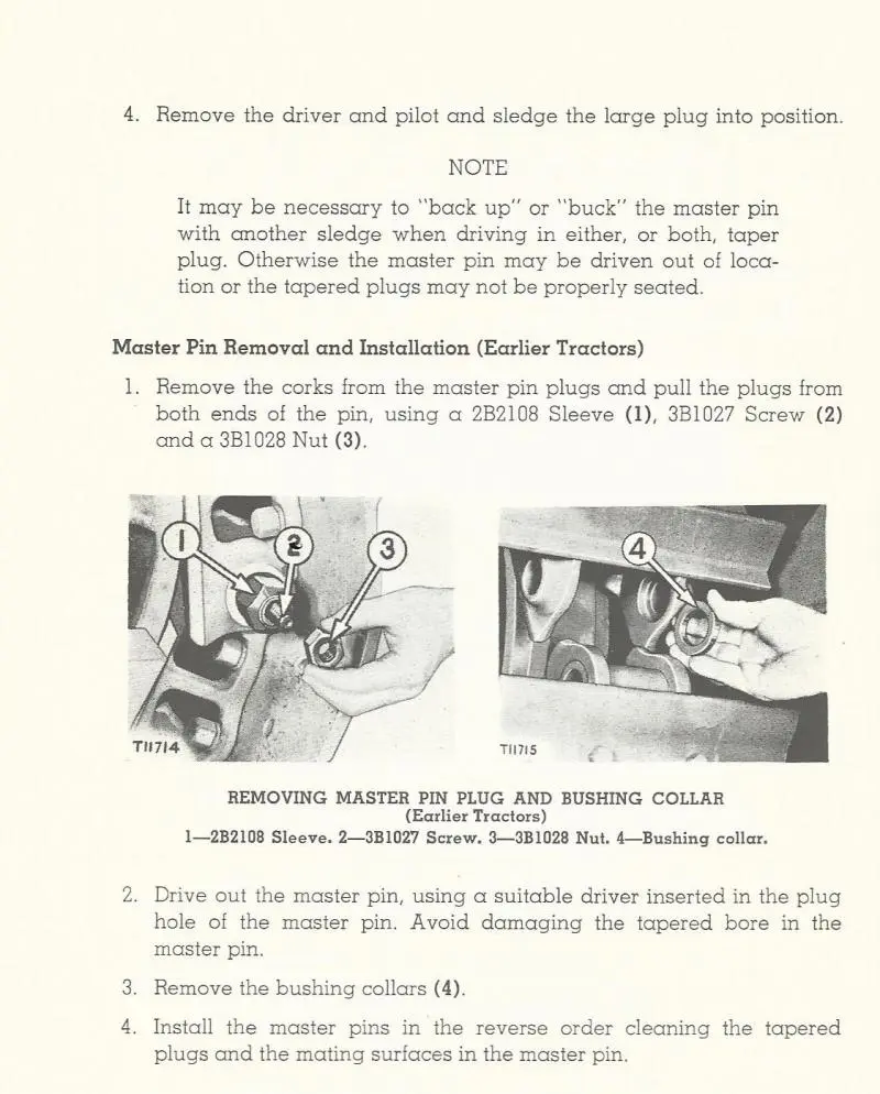

I need a pin pressed out of another machine next week and was wondering how a D47U comes apart.....pressed as well? I believe one side needs a idler bearing and might as well do both while the guy is here.
Fri, May 29, 2020 10:49 PM
Some D4's had split end pins with wedge plugs. Unless it has newer rails with a standard pins.
Sat, May 30, 2020 12:25 AM
Posts: 2,763
look for cork in the end of the wedge plug--if so remove it and there is threads in the plug to pull it out
Sat, May 30, 2020 2:13 AM
willwingo
Posts: 490
Thank you received: 5
Reply to dpendzic:
Here is what the D4 Tractor Servicemen's Reference Book, form FEO30521-02 says:
[attachment=59005]pin removal d4 early.jpg[/attachment] [attachment=59006]pin removal d4 later.jpg[/attachment]
Seems unlikely that a 7U would still have one of these style track pin systems - probably replaced with a drive in/ out pin.
