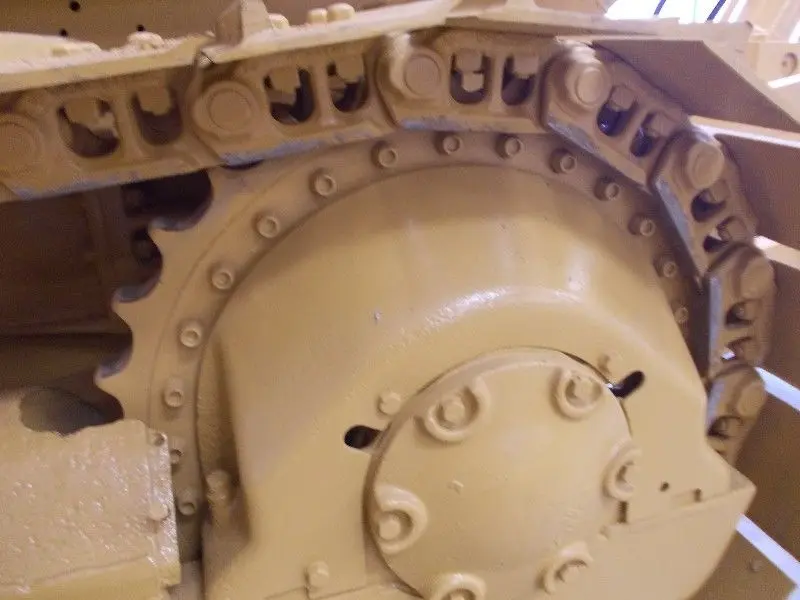

I have asked the aftermarket dealers for a couple of years if there is no adaptor ring and segments available for the D4D/E and they tell me not, but then I have seen two machines advertised with this setup. Never seen them in person. Both machines were imported from the Netherlands as I understand it.

that's very interesting and well worth following up on. Perhaps it's a one-time change to fit a modified sprocket that accepts segments. Specs on both the sprocket and the segments (and possibly the chain) would be welcome information on ACMOC. Any chance you can get more information?
Thanks for the info Glum. Those sprockets could be the origin of the rumor I heard about bolt on segments. Tony.

Notice it's not segments but a whole bolton wheel.

Hi John, I thought I detected a line at the 10 o'clock position indicating a segment but my eyes could be deceiving me. Could be just a mark.

You know what? I think you are correct. When I first saw this I thought what a great idea, just replace the whole wheel because it would all be worn the same anyway. Then on further thought, Oh Oh the whole thing has got to come apart to change the wheel. Not a good idea after all.
Thank you for noticing and responding.

I did email the sellers asking if they could provide me with a bit more info, but never received a response and I never took it further than that. Does look to be segments to me too.
