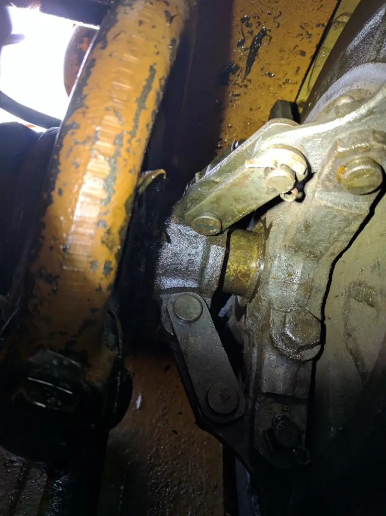

Hi all. I'm new, just picked up a new to me D47U 2 weeks ago. After getting her to new home and changing engine fluids, I started testing it out. She worked good for about 45 minutes. I first threw a track off (another topic later), but using a neighbors backhoe to pull the dozer sideways and rolling her forward we were able to get the track back on. About 10 minutes later the dozer would not move (she took a big bite of dirt) Raised the blade, still nothing. I let her idle, while I looked around, didn't see anything obvious. I went and got the tractor fired up to try and pull her out, hooked it up and no dice. But I was able to move the dozer about 10 foot, getting her to level ground and out of the mud.
After reading here, I got lot's of ideas.
Next I opened the top and lower inspection for the clutch housing. It was grimy and bit wet. I drained what was sitting in there and then closed it up. Then poured about 2 gal of diesel in, letting it run and sloshing around. It got most of the parts and 80% of the grime cleaned up. Drained the muck, tried to engage, no go.
Now when I say no go, if I engage the clutch 5 times. 3 out 5 she goes no where, 1 she might move 6", 1 she might move 2'.
So I'm thinking that it is the main clutch needs to be moved. Now I've crawled under her, and I'm trying to adjusting collar clamp nut bolt. If I'm on the right bolt, I cannot get it to budge with 25" breaker bar, nor a 4' pipe on the ratchet with someone helping me. I've tried both that bolt, and the nut on the backside of it. I've attached pictures (not the best) from underneath inspection, is this the correct bolt to try and loosen?
Other thoughts?
[attachment=39149]IMG_20161127_114305.jpg[/attachment][attachment=39150]IMG_20161127_114311.jpg[/attachment]

First off welcome, and congrats on your D4 purchase.
As to your question, yes that is the correct bolt on the adjustment collar. You'll want to disengage the clutch before attempting adjustments. After you get that bolt loose put the tractor in gear and set the brake. Then turn the collar clockwise towards the flywheel. Snug the bolt up before you try your clutch to prevent stripping the threads on the collar. I don't remember the pounds of pull needed but the clutch should have a good pull and a distinct snap overcenter. Once you get it where you want it tighten the collar bolt up good.
Good luck and have fun

Thanks Bruce for confirming for me.
For folks that have made the adjustment, is this bolt common to be seized? Any tips on getting it broke free? I assume I don't want to apply heat?

Spray it with some PB Blaster or such the day before and let that soak in. Tap the head of the bolt with a hammer. Undo using a short but sharp motion on the wrench - idea is to turn the threads rather than twist them (the old brick hanging between two bits of string concept) but to use a short motion in case it really is stuck in there, so that you don't actually break the bolt. I sometimes hit the end of the wrench with a hammer (lightly) to get a rapid motion. You can also make a quick tightening motion first which can move the threads before turning it back out.
