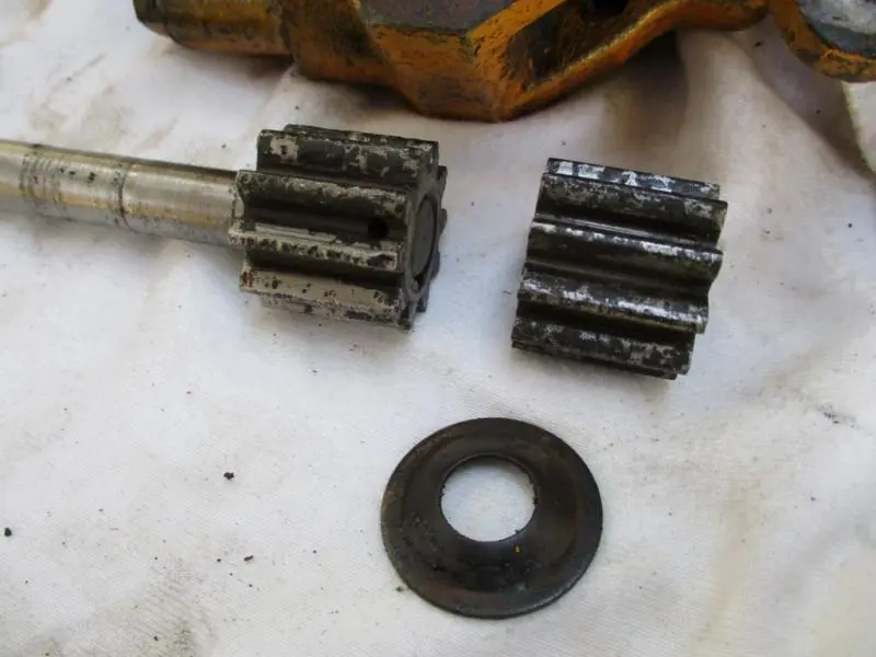

I'm working on my D4 7J fuel transfer pump right now, for the second time, you will see in another thread how the camshaft gear in my 7J decided to strip teeth, so I pulled the transfer pump initially because I wasn't getting fuel pressure at the tower, the same problem you have. I took a heap of photo's of the internals this afternoon for your benefit, it will allow edb, who is a pump expert, to better guide you, he generously helped me rebuild my pump a few years ago, and made me some special tools that are necessary if you intend working on yours.
It's not rocket science, but it is easy to screw up I found, plus those transfer pumps changed design during the D4 evolution from RD4 through D4 7J to 2T/5T to 6U/7U, so what the parts book, or even Cat Inc tell you parts that should fit, is often wrong. The key thing is to try and avoid dismantling the inner seal section of the pump if possible, UNLESS you are sure the seals have failed, so DO NOT remove the rear drive gear at this stage.
edb will confirm this, but my gut feeling is if the seals are bad, the engine oil level in the diesel motor will increase as fuel leaks past the seals in the pump into the fuel tower housing, from there into the sump, so if you are not making engine oil, then for now assume your seals are OK, that will make this job much easier for you. I'm pretty certain the later D4 pump has a shorter drive shaft than the 7J, and I've seen pumps where the drive gear is completely different, so it's not a simple matter of switching in a new pump, the D4 7J pump is a bit of a orphan.
As ccjersey said, those transfer pumps move unfiltered fuel, so any trash in the tank goes through the pump gears, also, because the pump is the lowest point in the fuel system, it's where all your water will find itself, and sit, so tractors that aren't driven for years may have badly rusted transfer pump gears, and drive shaft, you will see that in my photo's. The pump is very simple, but the running surfaces must be good, as edb mentioned, hand lapping on a piece of glass can often save parts, but if the gears are badly rusted, or worn, it's best just to buy replacements.

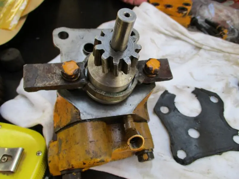

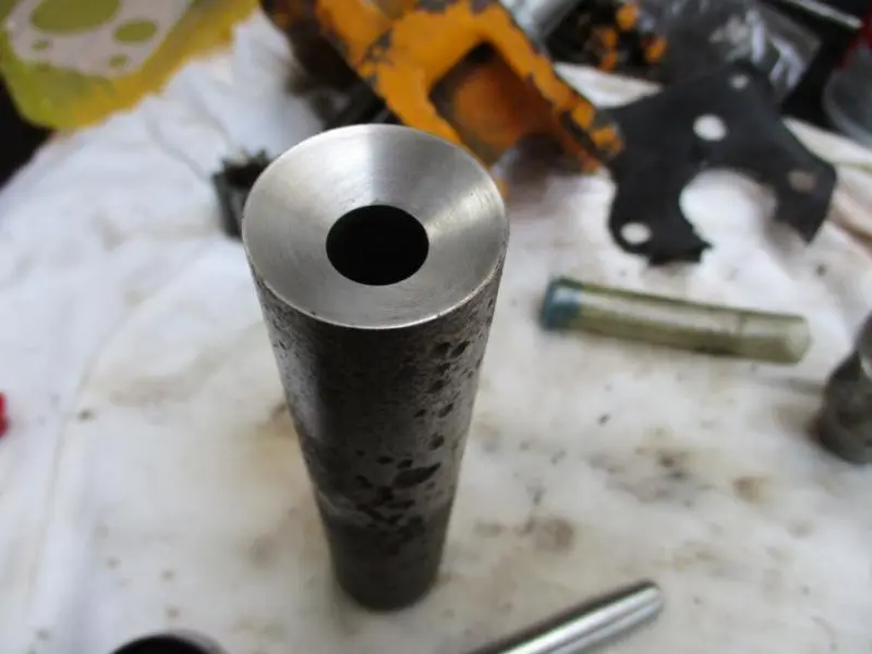

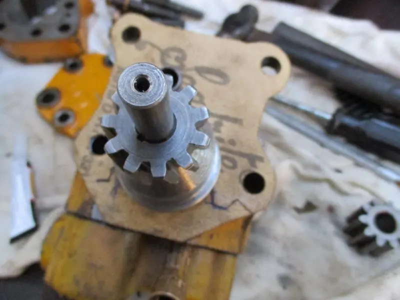

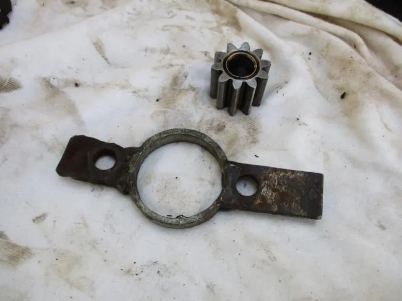

You will see in the photo's a simple clamp that edb made for me, if you do have to fully dismantle the pump, you will need to make one of them, because until you get the drive gear secured safely on the shaft, there is the very real risk the springs inside pump, holding tension on the seals, will force the pump apart again. You will see the old original gasket from my pump in the photo's, it's busted a small piece out, please overlook that and imagine the bottom section is still in place. That is how the transfer pump came from the factory originally, with a one piece mounting gasket 4B5098, later Cat went to a 2 piece idea, with a small circular gasket to sit under the "Seat" 3B4749, and a different, larger mounting gasket that surrounded it, you will see that in my photo's too.
If your pump is like mine, you will need to decide what gasket system you use to refit the pump, if your original mounting gasket get's damaged when you pull the pump, but be aware you will need to at least make the larger gasket, as it's not available from Cat. You will see in my photo's the one piece mounting gasket I made this afternoon, I'm sure edb will comment on this, if you do not fully dismantle the pump, you will need to get creative and cut your new gasket to fit over the "Seat", then glue the gasket back together.
One thing to watch when making new gaskets at home for any spot on a Cat, is to duplicate the original thickness, because gaskets are often used as a spacer as well as a sealer. My old original gasket 4B5098 measures around 0.027" thick, interesting the new gasket Cat sell for this job, but won't fit my pump, is thicker, it measures around 0.035", not sure why the difference, maybe my original gasket just got crushed over the years, or Cat changed the specification. I had a roll of 0.027" thick gasket paper, so that is what I used to create the new gasket.

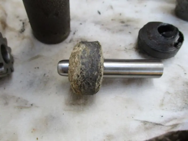

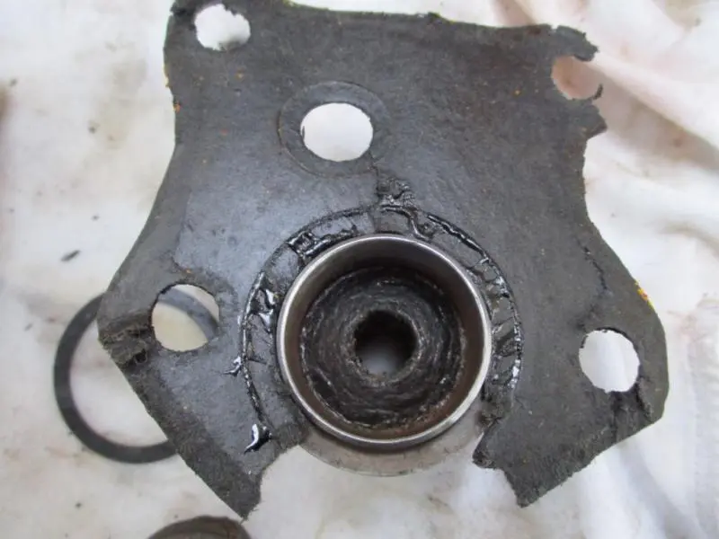

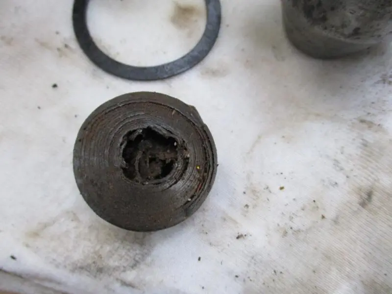

They say a pictures worth a thousand words, so hopefully you get some help from my photo's, I have spares of these pump parts, so don't think the photo's are from just one pump.
Cat Inc changed the design of the shaft seals, which makes them far more challenging to fit than the old original seals, if you need to go down that path, the new seals will unravel very easily if you are not careful, and it is easy to damage the internal bores cutting them on the keyway for the drive gear. You will see in my pics the 2 special tools edb kindly made for me for fitting new seals, one with the dished face for firmly seating the new seals into the "Seat", the other smaller pencil shaped tool for protecting the inner bores of the new seals.
I'm no Mechanic, just a dopey farmer, so I found it very challenging getting the transfer pump sorted, and was very appreciative of the help I got from edb.

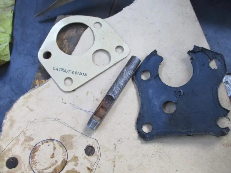

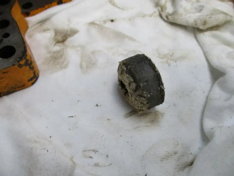

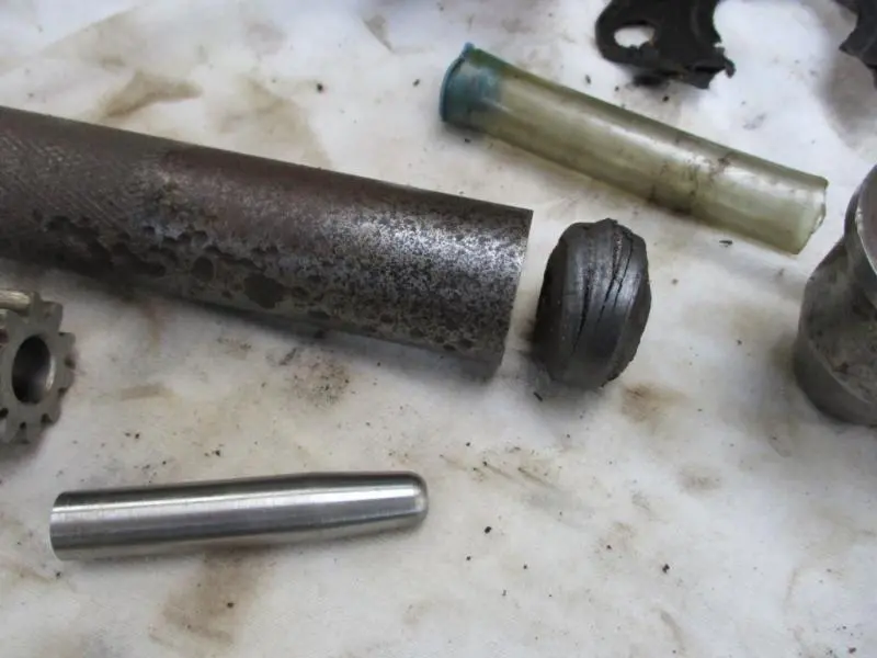

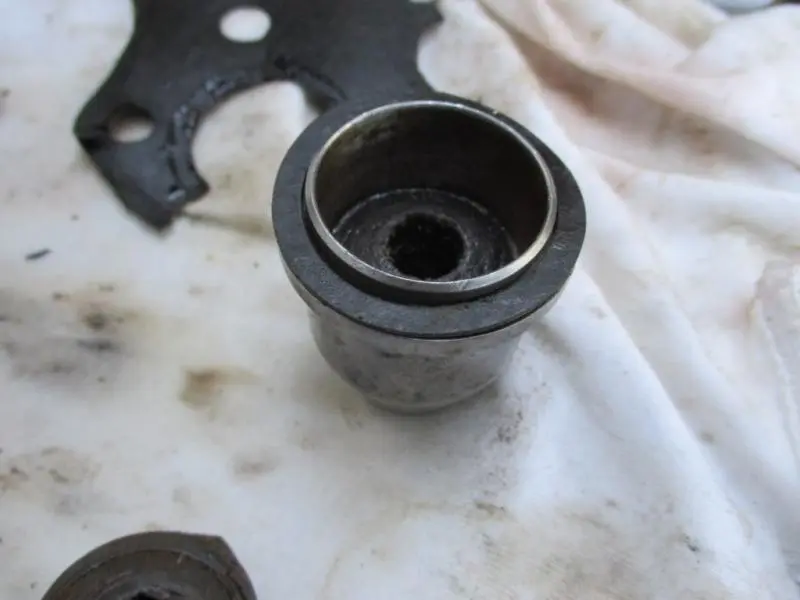

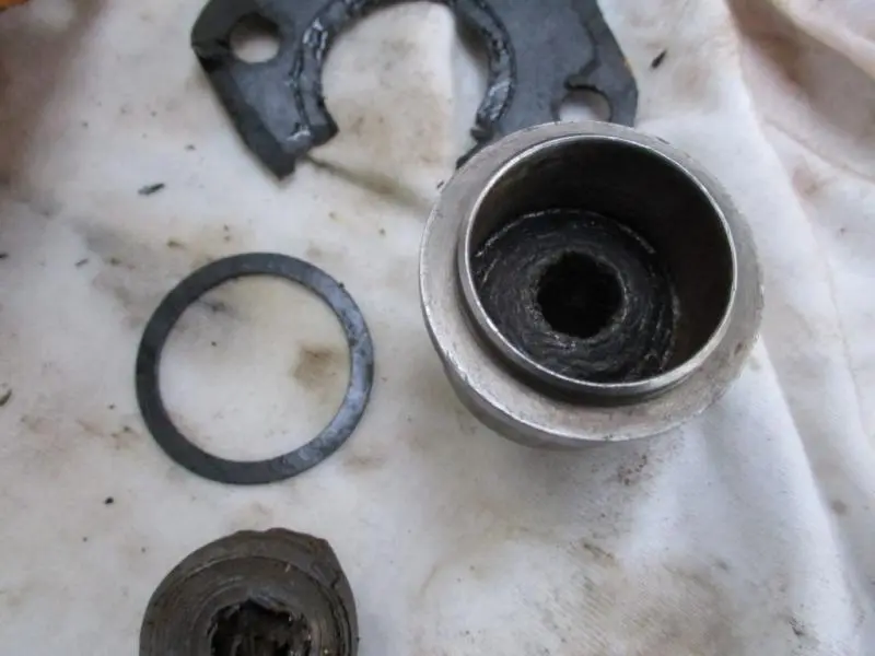

Special tools I mentioned, and the pump shaft seals, the last photo shows the old style seal in one piece sitting on Eddies special tool, and the newer Cat seal that loves to unravel if you look at it wrong, and easily pulls the center bore out, they are nasty.

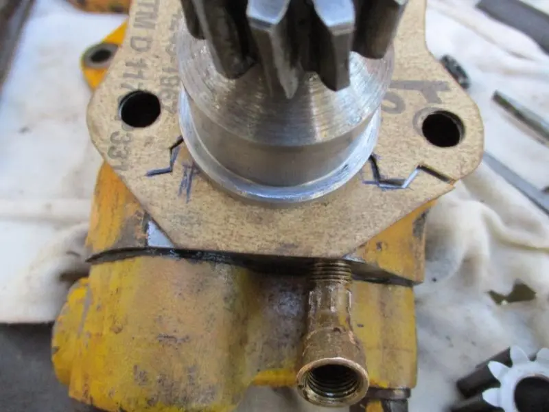

Mounting gaskets, the original gasket is in photo's #1 and #2, it was accidently busted when I pulled the pump years ago, it is not available from Cat anymore, their replacement you will see in the photo, will not fit the 7J pump, so you will need to make one. Note how I cut my new gasket to allow it to slip over the "Seat", I have glued that zigzag cut back together, and will use Permatex Aviation Gasket Sealer on both faces of my home made gasket.
Hopefully it all works OK, I'm the first to admit I'm not the sharpest knife in the drawer.
