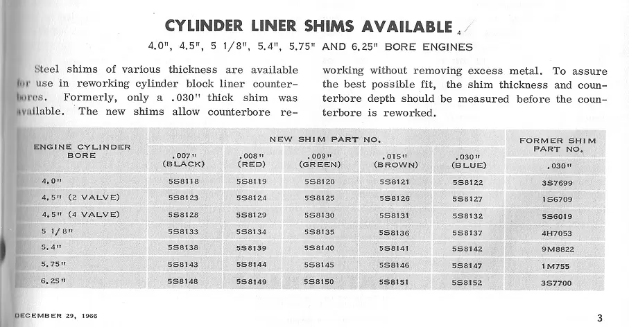

Has anyone ever used shims to correct cylinder liner protrusion on a D4600 engine (D6, 4R1143)? I am pretty sure if I went this route, I would need to order custom shims. But all things considered, I would rather go the shim route than resurface the block deck, because this one is straight and clean.
There are two problems with the counter bores at present. First, they are uneven .002"-.003" between the high side of the bore and low side, and on the low side I am only .002" above the block deck (this is measuring liner protrusion on 3 cylinders.) And I tried rotating the sleeve in the bore, and I tried different sleeves but the measurements didn't change. Because my counter bores measured consistently across all 6 cylinders, I stopped measuring the cylinder protrusion on the remaining cylinders.

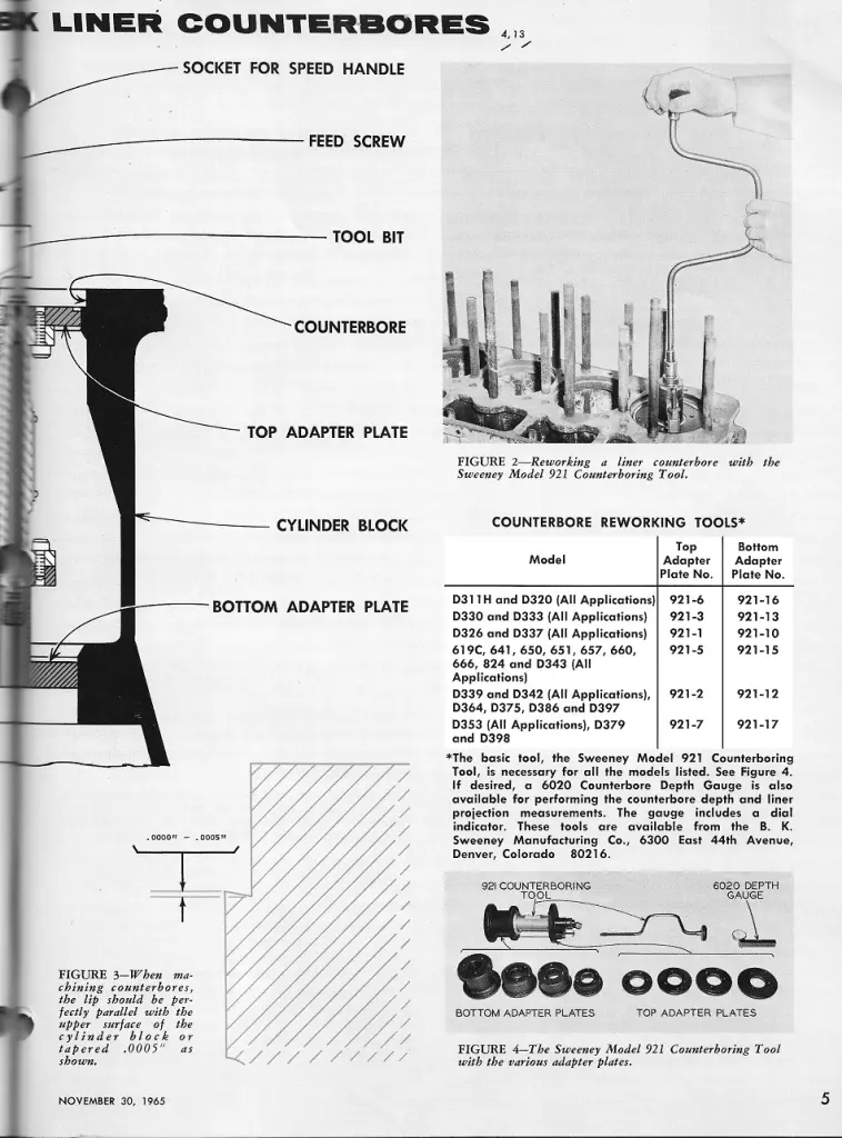

My goal is to have an engine shop take enough off of each counter bore to make them equal all the way across and leave the deck as is. Am I going in the wrong direction?
So far I've found Phoenix Specialty Manufacturing online for custom shims. If anybody has other recommendations for another manufacturer, or a different solution, I'd appreciate it.

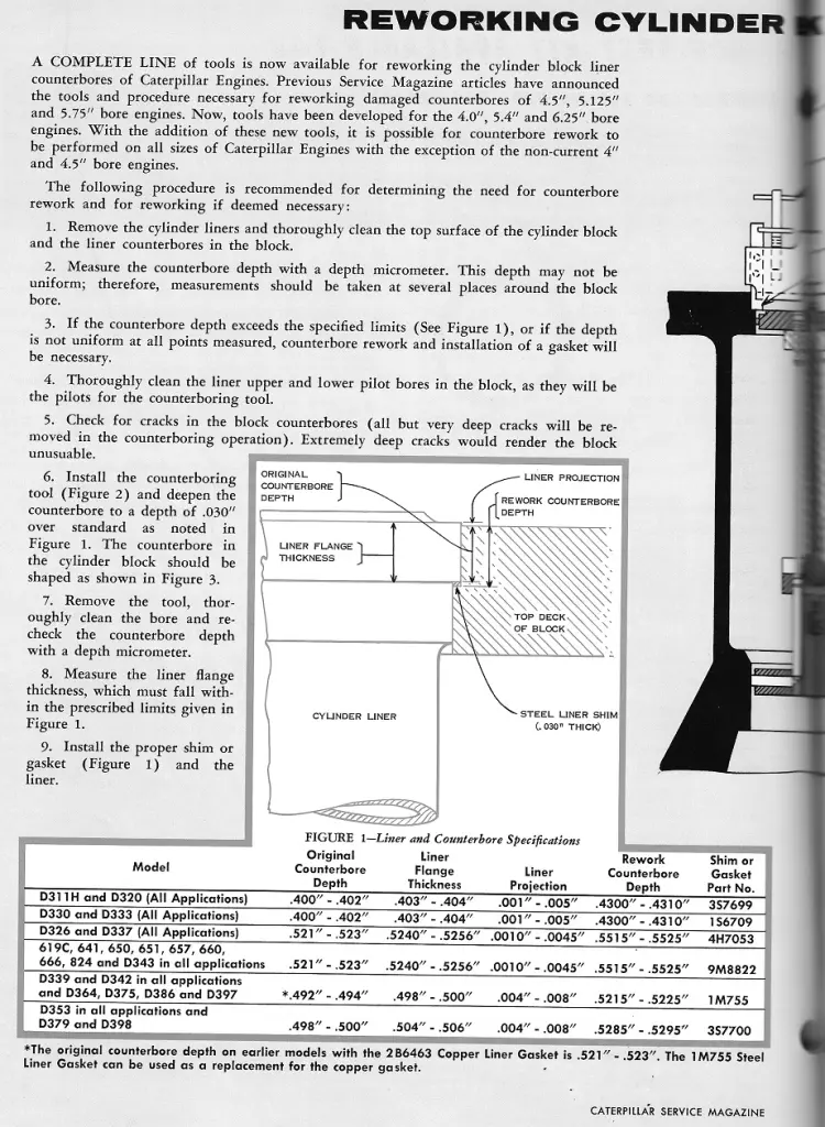

Using a depth micrometer, the ledges (or counterbore) in the block are consistently off by as much as .003" in some places. I don't have the right stand to use a dial indicator. So, regardless of whether I rotate a sleeve in the bore 90 or 180 degrees, I get the same measurements.

Also agree that your counter bores need truing up and are most likely the real problem.
The counter bore steps need machining to square them up to the top deck and crankshaft, you will then need thicker shims/gasket/washers to reset the liner protrusions to spec.
It was not unusual to have to use different thicknesses of shim washer in each liner counter bore as we only ever machined the absolute minimum to clean up in any counter bore.

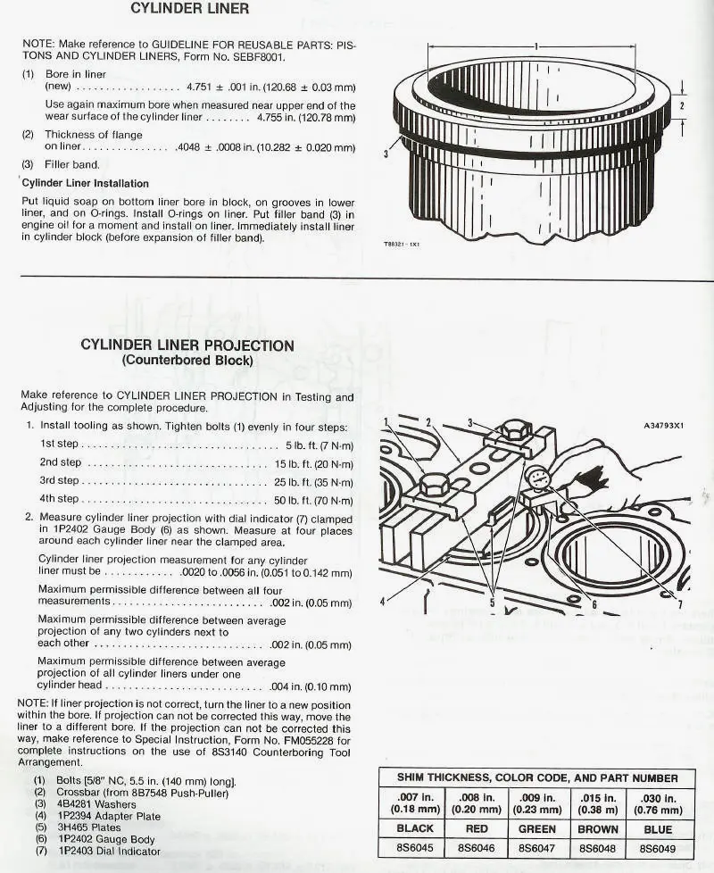

Scans may help.
The Liner Projection instruction holds true for all Cat engines even though it says for 3306 engines.
A depth mic., vernier and carefully, even a short suitable straight edge and feeler gauges can be used to measure the protrusion.

Eddie B., thank you for clarifying whether this information applies to earlier models than what your scans specifically call out. You posted this info a few weeks back and I wasn't sure whether it could be applied to the D4600. I'll definitely need to have shims made, but won't know what thickness to go with until the counter bores are cleaned up.
