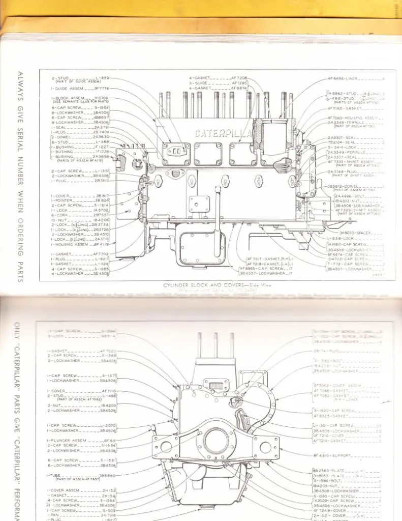

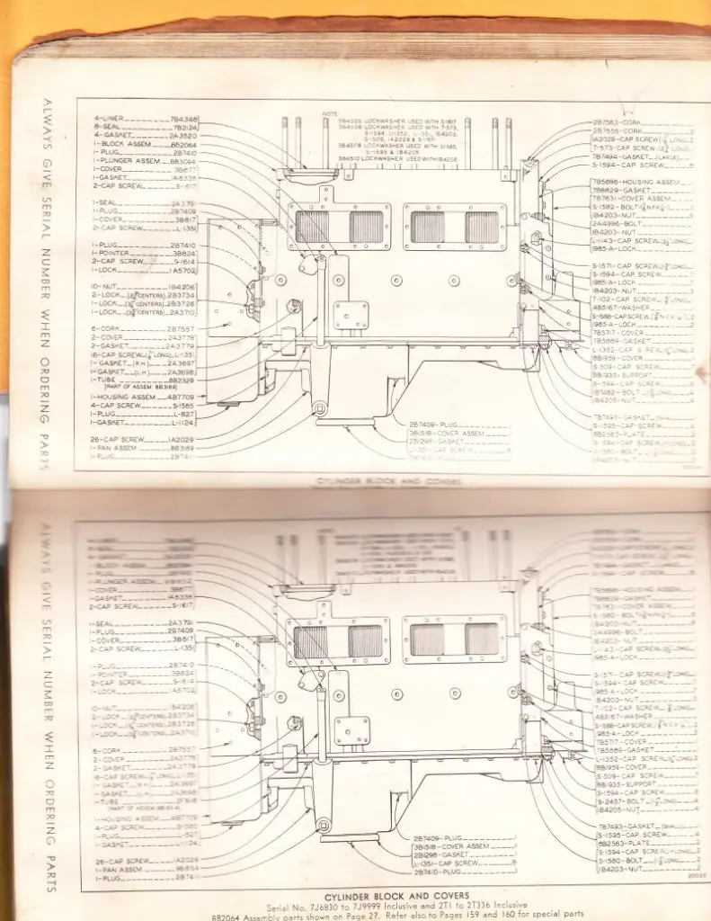

Here are a couple of scanned images from my parts book.
You might need to clear up what this engine is out of, a serial # or a year.
The updated part numbers are now 3S3977
JVMMOPAR Does this look correct?

Dratt. That first picture is a D315 I can't quite make out the SN range but I think it says 7U. The second definately is a D4400.
