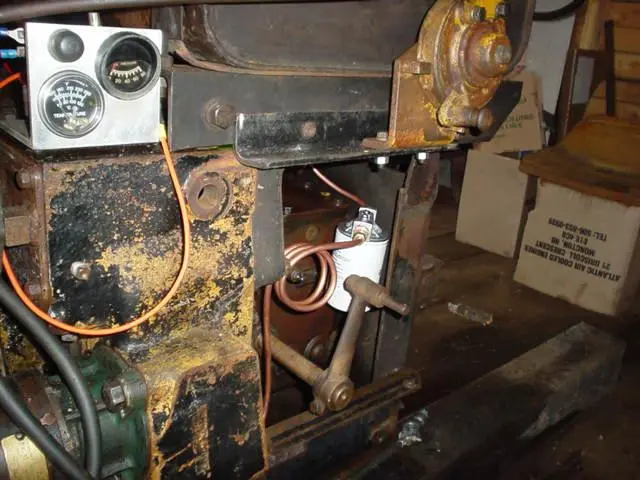

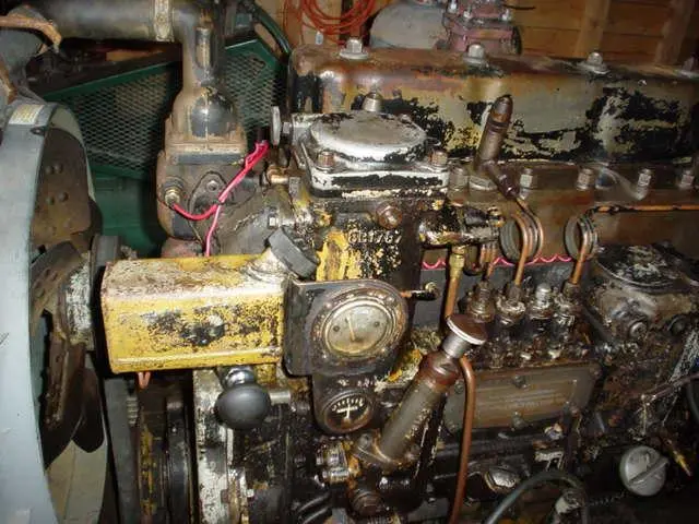

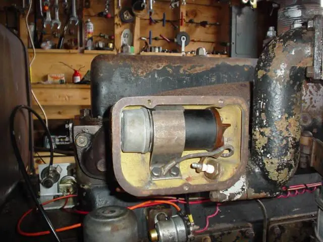

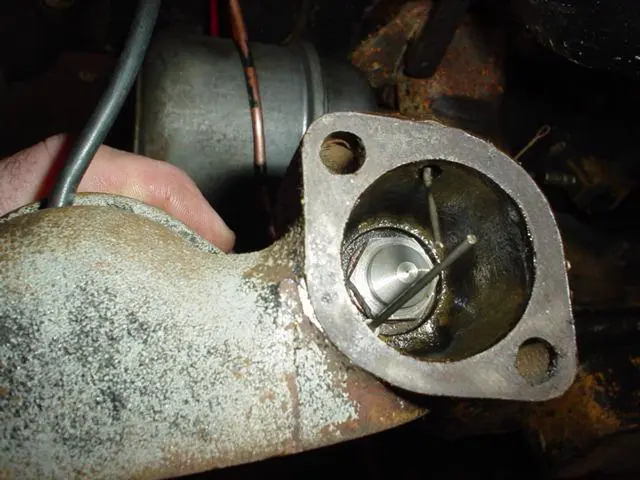

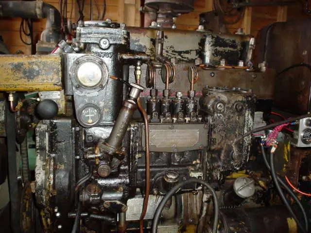

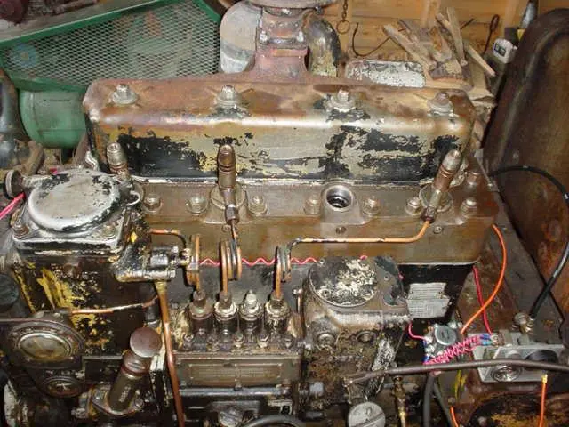

Hi guys its me again...
I've been working on the powerunit quite a bit as im on vacation.
Worked at the flamethrower do-dad that's in the intake manifold.
I would like to get it working so the little guy starts with out getting hooked
on the either bunny.
I dont think it was being used the last times the engine was running,so the wireing was missing.
Any idea if this thing uses 12 or 24 volts,I looked at the coil that generates the spark but it has no visable markings.
I wired it up with the start solinoid because there is a warning to only use it when engine is cranking.
I would think that I would roll the engine with the fuel rack in the off position and pump the handle. As pressure is built in the line and this trips a switch which allows the coil to generate a spark at the sparker.
This should ignite the fuel mist in the manifold on its way to the cylinders.
With some heat in the cylinders the throttle would be advanced and it should start right up.
Sounds awesome on paper...does it work.
Aint got a clue,but im getting there.
Not sure how long to use it when attempting start.
And just because im curious,whats this things proper name.
Thanks again your faithfull reader Chris

Have some pictures ,I think.
