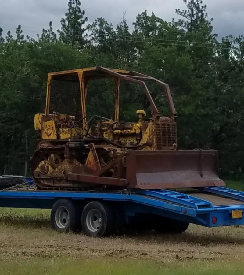

Hey guys, I just picked up this D4 7j off of market place to fit into my RD4/D4 5t collection. I got it for scrap price with a seized up motor and have spent the last few days freeing her up.
My problem it shes only beating on two cylinders MOST of the time. I can pull and turn the two front cylinder injectors , point them up with the motor running and no spray. Until I whack the throttle from idol or put a load on it at high RPMs. Then it's got Beautiful patterns.
I've switched injectors around, set valves, checked the rack traven, and slide alignment to injector gear mesh. and it only is an issue with the front two cylinders(no matter what injector) that will only spray when the load is maxed. Via a fast whack to wide open from idol or hi load(trying to pull up my driveway in 2nd.
What direction should I look? Pull the pump plungers?
I have a spare parts RD4 to swap parts off if any of you have any ideas on how to diagnose it?
