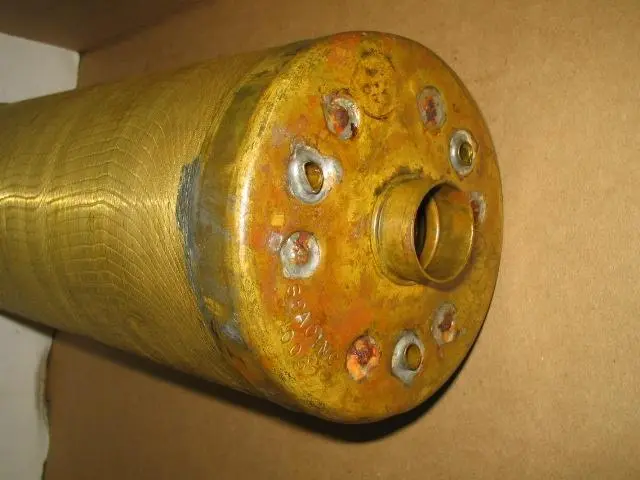

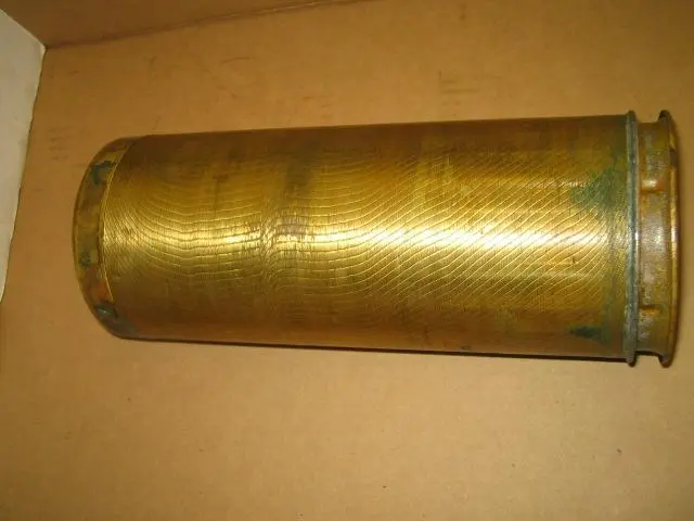

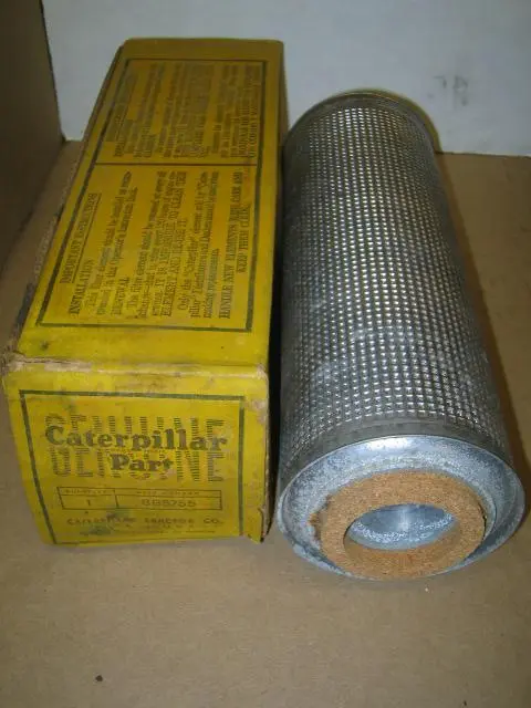

Attached are three photos of an after market outer assembly 6b1851 for the crankcase filter on my D42T tractor. Also is the 8b5755 metal mesh inner element that fits inside 6b1851 above.
Those of you who have seen these, do they look appropriate for the original bypass flow (pre-full flow) filter housing switch over? I am not planning on making the switch over and parts are missing.

Those numbers are good.
The 8B5755 inner element shows up in the 4R D6 (D4600) tractor. The D4 would normally be a 6B907. They both use the same filter housing and parts so I don't seen any reason why they would not work.

Regarding inner element numbers my parts book form 9068 shows the T top and calls for a 6B907 element and a 6B1851 element assembly. Another parts book I have form 8480 dated March 1944 lists the element 8B5755, (purolator #24901), and the same outer assembly as shown. I opted for the earlier number due to the date of publication of Form 8480 relative to my tractor.
