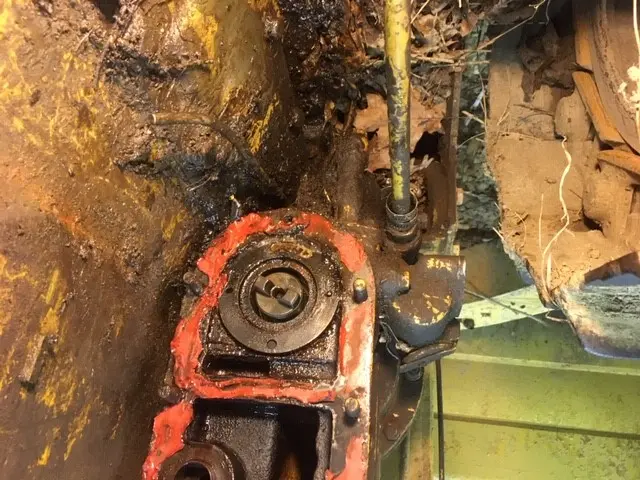

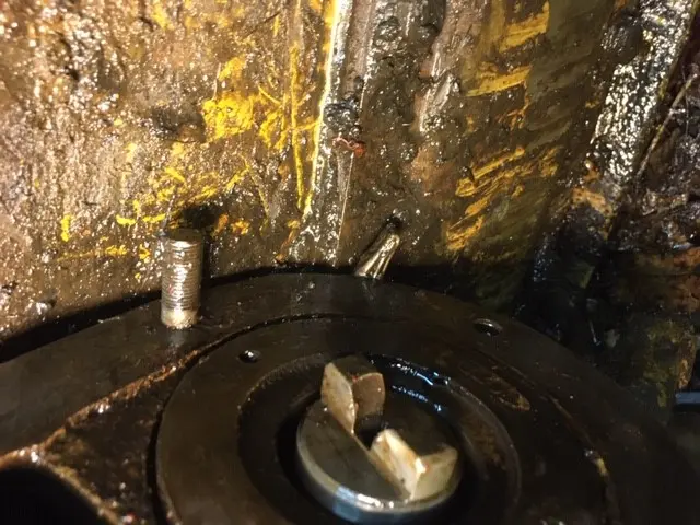

[attachment=56670]tower.jpg[/attachment][attachment=56671]transferhousingback.jpg[/attachment]This thread is started aside from the Clutch Starter Pinion topic I have going so search by others will may be simpler.
I have removed governor separate from the Fuel Transfer Housing. It was a good move-once cleaning things up a little, I started to see Permatex oozing from between the tower and the injector housing. Also the lowest nuts next to the block on the injector housing were missing-I did gain a 1/2" drive extension with a 1/2" socket 😊.

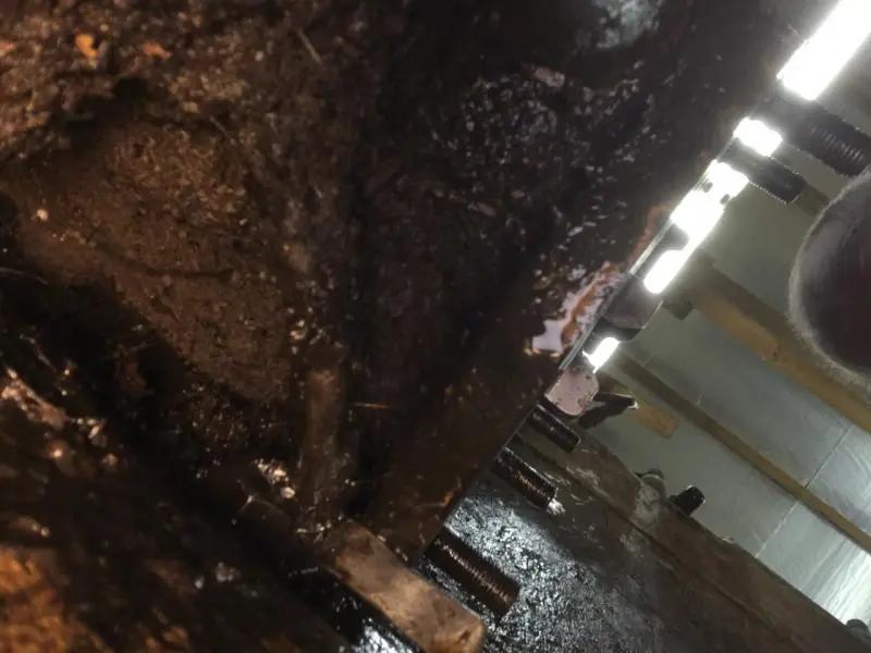

Question: The pics will also show a 'tang' or something at the back right of the tower against the block that seems to be mounted-cant see what it is, the only think I can think of is that is something to help hold of the weight of the injector housing. Any ideas if this has a purpose? [attachment=56668]transferhousingmetal.jpg[/attachment][attachment=56669]transferlowerback.jpg[/attachment].
Also, I found a random small diameter steel line that looks like some sort of drain. It was clamped to the block next to the tower drain line. It looks like it was bent over and never reconnected. Anyway, are there two steel drain lines?

….found the purpose of the random drain line tube..part number 7B3259 drains from the base of the injector housing....

Any thoughts on that tang rear lower right against engine block. There has been work there before so hard to say with what I found back there.
Thanks!
Bernie
Hi Bernie,
quite likely a wedge used to try and align the 1/2" drive 9/16" socket and a nut to the lower stud there--found odd tools in that location behind the fuel filter and injection pump before when working on these things.
Cat came out with a 3/8" drive 9/16" -- possibly P/No 8H 8564 -- a close coupled uni-joint socket that got in there really well. Prior to that it was a real fight to get the nuts started and tightened especially when I only had 1/2" drive gear.

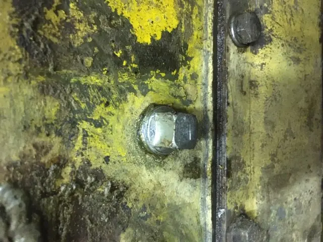

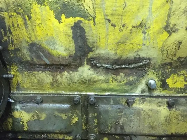

After cleaning off the grit and grime it looks like at some point something went through the block and repaired with welds. One other find was a plug that looked tapped into the side that was severely boogered up. I replaced it with what you see.
Behind the blind hole there is a fiber type coating on the backside of the blind hole. I think if I would have kept scraping at it, it would have gone all the way through.
Any thoughts on what it may have been for and if it had anything to do with the repair welds on the same side?

Those are freeze bulges, it froze at one time or another. Not sure what that plug was for but to the right and up should be another plug that drains the coolant in the block.
