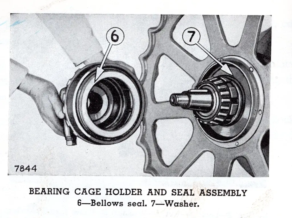

Is there any chance removing the outer bearing and unbolting the cap from the frame lifting that side a bit - would give you enough room to slip the new ring in after cutting away the old??

With the Bearing Cap Assembly removed may be possible to get the cut ring out and slant slip the whole ring in.??
