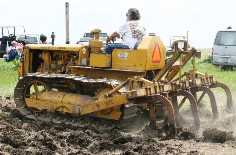

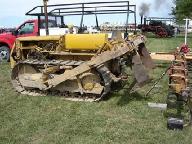

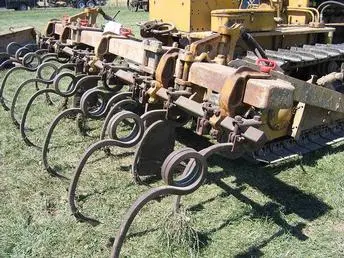

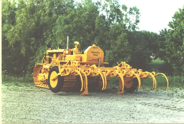

heres a few pics. a d2 with a cat subsoiler/cultivator set-up,(small beam on large beam + gauge wheels) a d4 with cat subsoiler and my 2 d4s, one with cultivators the other with chisels.

Great pictures! I hope to have one soon. The rubber tires on the cultivator are guage wheels, they cat be set to different depths, or is there another hydraulic cylinder to set the guage wheels?

Gauge wheels are only manually adjustable, not hydraulic. With gauge wheels, I expect you are supposed to put the hydraulic control in it's "float" position so the toolbar can follow the contour of the ground properly.

according to tool bar manual, always use float position for all tools in the ground. some tools (like subsoilers) don't use gauge wheels and those tools tobe angle of attack adjusted to set its depth.
