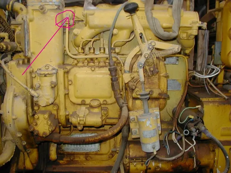

As long as there is no fuel pressure
As long as the fuel pressure gage did not move
You can not start the engine
There's smoke but no starting
Overflow pipe
It comes out on the right of the fuel filter
It has a spring valve
Check the valve is not stuck in an open position
Check fuel supply in Engine connection point

Jusy curious, if the valve were stuck in the oper position would'nt fuel be comming out of the tube?? I did check for fuel and did not see any comming out when cranking. I also checked the injection pump and all plungers are moving.
Mon, May 16, 2011 3:04 AM
Posts: 2,766
Reply to Digdeep:
have you checked the transfer pump intake--has a spring and check ball that gets crudded and rusted up?--its right where the fuel line connects
