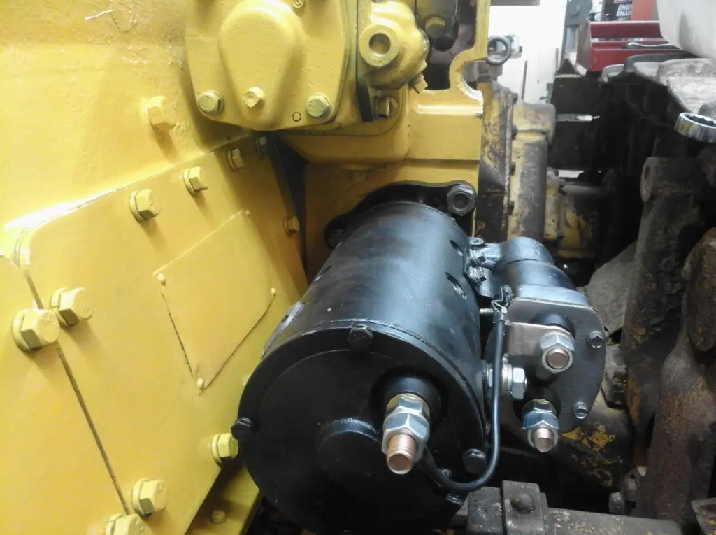

Good morning! A local starter builder built me a starter for my D4 7U. It works great! because I am leaving the pony set up on, my starter's solenoid is sticking out the side. I will need to build a cover for it and attach it to the lower side cover. Does anyone here have a picture or two of the modifications to the side cover or at least a description of what they did? I know I can't be the first to do this. If interested, once I am done I would be happy to post a picture of my creation. Thanks all! Elton

If the conversion is done with the correct parts the solenoid does not hang out the side.

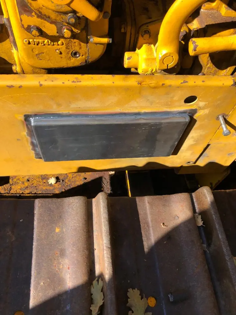

OK, even with the best fit there is a slight protrusion of the solenoid housing. Here's one solution. Also have used a section of thin wall pipe/tube to form a blister.
[attachment=62057]D4 side panel modification for DES.jpg[/attachment]

the piece of rhs idea looks really neat and side bonus even looks like it belongs there also it would stiffen that panel a bit too and its easy to source and cheap.

OM's job is very neat and effective. My 12 volt truck starter solenoid sticks out more than that so I'll make a deep D shape and I think it will work ok. Elton

Looks like there might be enough room to reclock the starter motor on the nose cone and put the solenoid straight up. Not sure if you're motor will do that but a lot of the ones I've dealt with don't have to be in any certain position. Clearance with the starter pinion might be a problem also, but could be worth checking into.

With the right lever housing and drive end housing the solenoid clocks in the verticle position.

There is just not room to reclock the starter, either it interfers with the bolt or stud on one side or the pony clutch. VERY close but just didn't fit. Also if it went straight up then it would be really hard to drain the pony clutch at service time. I tried all I knew to try without cutting sheet metal. I do have a dry clutch so no plug required. I really hate modifications that look like modifications, so I hope I can make a nice bubble that will work well and be strong too. I'll post a picture when I get it all sorted out.

have you tried turning it clockwise so the solenoid is on the bottom of the starter?

Plain to see you don't know the tricks about getting around the close fit upper starting bolt. When properly fit the lever housing just clears the pony clutch housing. Still can access the drain plug. What really looks like a cob job is to have the starter solenoid hanging out the side.
