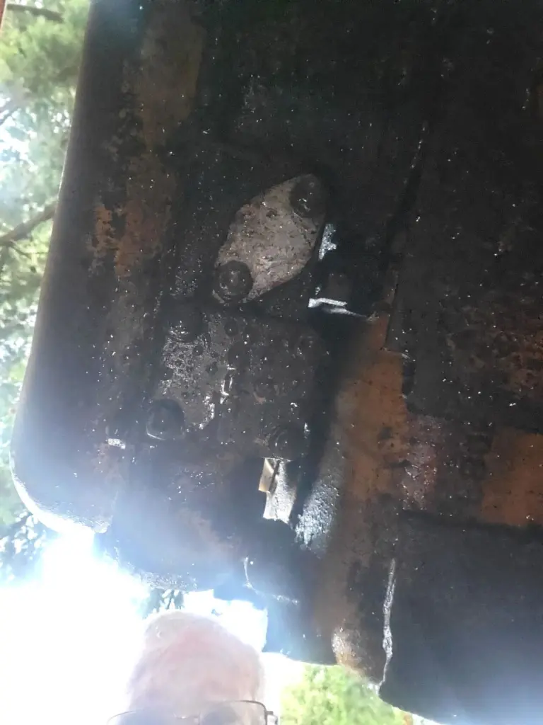

The hydraulic pump and reservoir is located on the front of the tractor on the radiator. I don't see anything resembling a hydraulic filter, other than the screen on the oil fill. I do see a 4-hole plate on the bottom of the tank, is this where the filter is located?

Since you are going to put new hoses on it, it would be relatively easy to completely drain the system. I would drain the tank then pull the front cover off to inspect and clean the interior, Cat still has the gasket, don't know about the filter, I would also pull off the hydraulic cylinders and position them so they can drain completely, it may take a couple days of tipping them back and forth and allowing them to drain, trying to flush out a partly filled contaminated system is nearly impossible to really get it clean.
That four hole plate on the bottom is where the filter lives.
The seal where the control lever shaft goes in to the top of the unit, is often where water gets in and may need to be replaced.
If you post the serial number of the hydraulic control unit, we may be able to tell you which filter it uses.
