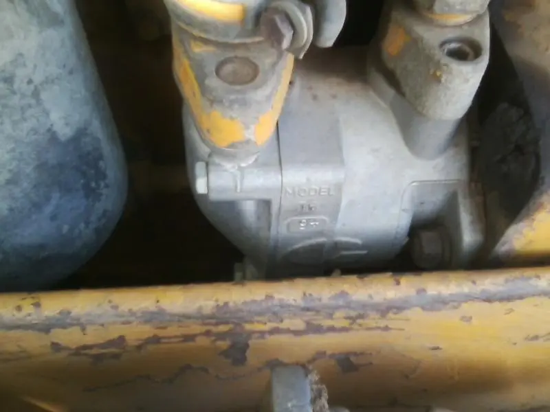

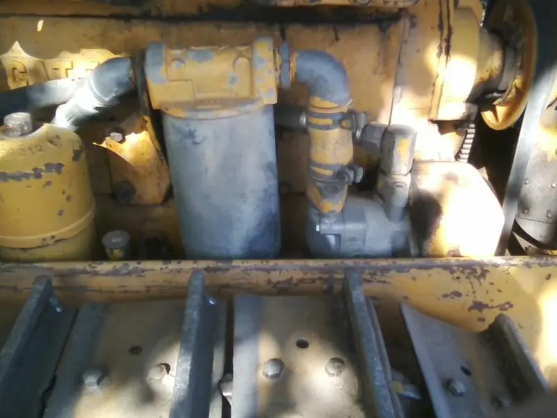

I have a D-2 with hydraulic pump attached to the generator mount. It is a (CW) clockwise rotation and has 9+ stamped on it. It has more than enough flow for one cylinder on a disc. Here are a few pictures. Gary

Prince makes a hydraulic pump in various sizes called a SPD(special version of the SP25. It has a recessed splined female shaft on the outer end to accept a second pump on the end of it. A shaft could be machined to drive the alternator in line from the output. They have them listed in the Surplus Center Catalog. Either direction rotation is available. www.surpluscenter.com or 800-488-3407. Line is 24 hrs a day. Pretty helpful folks but not sure if the advice is 24-7. Located in Lincoln, Nebraska[hr].
