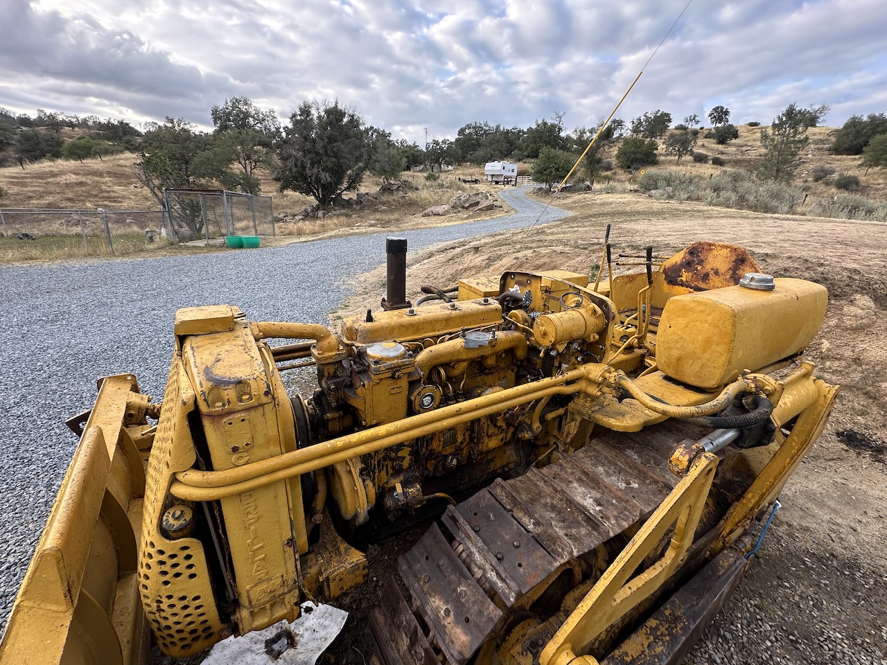

I have the same lift/ transfer pump as you. I'm dealing with low fuel pressure as well. 5 psi running.
Diesel engine runs perfect though...so far. Don't want to cause any other issues so far have....
  1. cleaned inside and out. It was locked up with tar from old diesel. Still seemed hard to spin by hand so may clean again.
  2. checked bypass spring and plunger. Stretched spring.
  3. replaced filters
  4. replaced gauge
I also need to crack the injector lines every time i start. Hoping fixing fuel psi will help. I'll post results.
D4 6U Caterpillar Dozer

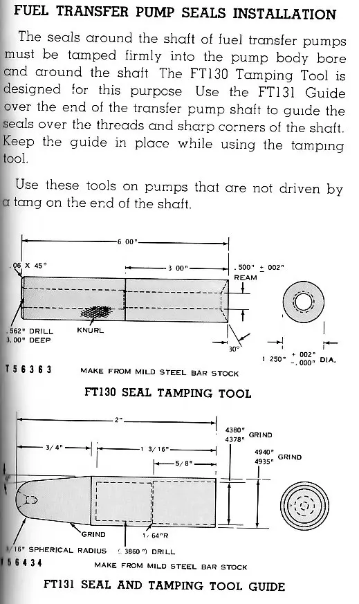

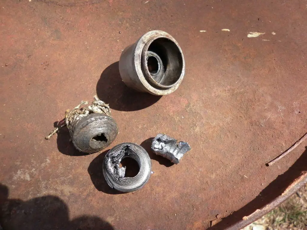

many moons ago I wrote up a detailed post on replacing the packing type seals on these pumps, the packing change material but I m not sure if the P/No changed at this time--feel it did not--I stand to be corrected
In said article was plans for the old named tamping tooling so we can make our own--NOTE the new packing MUST be pressed to squash them against the housings--if you tamp them as with the previous packings then the new style ones will be destroyed--there were pictures if such in said article.
Yeah, well, sorry about multiple scan loadings--phft.

I used edb instructions to replace packing and it worked perfectly
