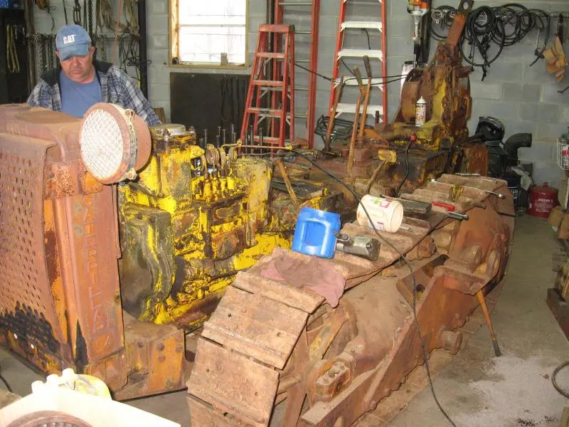

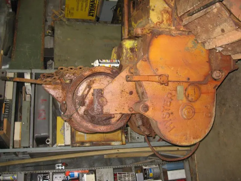

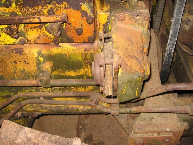

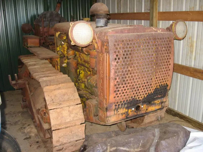

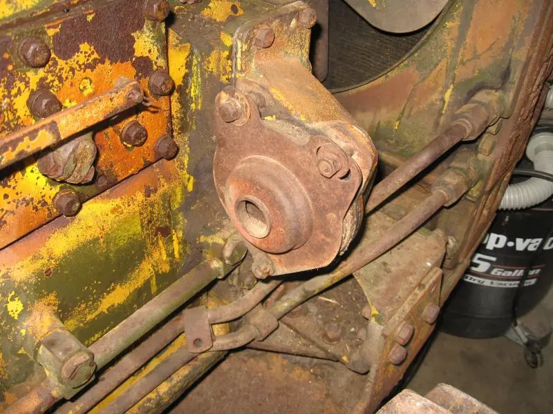

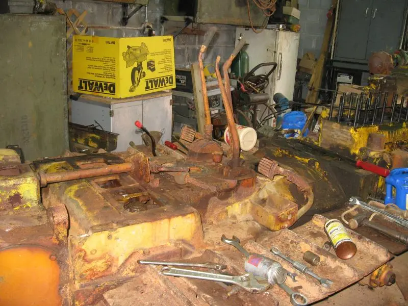

ok guys, here are some pics of the D4. I forgot to write down the serial number, but my grandpa said that it is a 2T.
you can see a little olive drab paint under the yellow in a few places

So I am bringing this thread back from the dead. I have started looking for a generator again. If you look at the pictures I posted there is a pretty good one of where the generator was and what is left. Any help would be appreciated.
