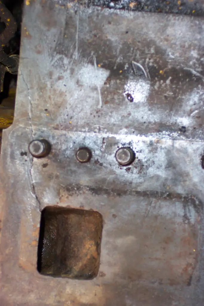

i had posted a thread concerning water in wet clutch.
ol magnet had posted a seal between the main engine and the bell housing.
so not realizing at the time to replace this seal the engine would have to be pulled and clutch housing seperated from the main engine to replace this seal!
whoo! what a job this would be. so i was going to cobble it for lack of a better term. i was going to smear JB weld sealant around the mating surface.
but when i pulled the pony motor off the clutch housing and cleaned surface.
and found a crack in the housing that goes right down inside the coolant port,
that leads back to the main engine via the clutch housing. not sure the depth of the crack but visible. so i suspect this is where my leak is coming from... i was still thinking about smearing the whole passage with jb weld.
in as far as i can reach.
this is crazy.
any ideas? any one?

Kind of unusual to crack there....must have froze at some time in its history. I don't know if you can reach the depth of the whole passage to do the fix you are suggesting but it's worth a shot. You'd have to get clean surfaces for anything to stick.

After sleeping on the topic😊 ....that thought also occurred to me....may be well within the range of fixes for the "Bars Leak". Give it a try, might be just that easy unless you've got the Grand Canyon of cracks in there.

how much bar's stop leak do you put in? is there a ratio of bottles per gallons, we all know they hold a lot of coolant!
it never leaked externally. i did wire brush and clean the coolant port and crack area, then heated the area and put j.b. on it as far as i could reach with my liitle finger. generally i like to fix things right, but i dont have the facilities to pull this motor out for the repiar and the time of year is not good either its getting cold!
by looking at this crack does it appear to be a casting flaw?
or as old magnet states possibly froze at one time.
i guess it does not matter it there.
thanks guys, for the input!
i hope the pictures is viewable.
i am hoping to put together by this weekend
and i will report back.

The instructions on the "Barsleak" will tell you what the recommended mixture is but I wouldn't hesitate to double that for a tough application.
Not my usual recommendation for a fix either but in this case you are not likely to hut anything. May get you by until you can locate another clutch housing along with some decent weather to change it out.
That is a nasty crack that would surely be a candidate for your water leakage problem.
Looks like a freeze crack to me, nothing to do with casting flaw.

Bars Leaks is a product that is usually only good for blocking the few remaining good tubes in your radiator .. 😞
I'd be using "water glass", more commonly known as sodium silicate .. which is usually a satisfactory fix for sealing hairline cracks in heads, blocks, and any other castings that are in contact with hot coolant. The cooling system needs to be brought up to a high working temperature for best results.
