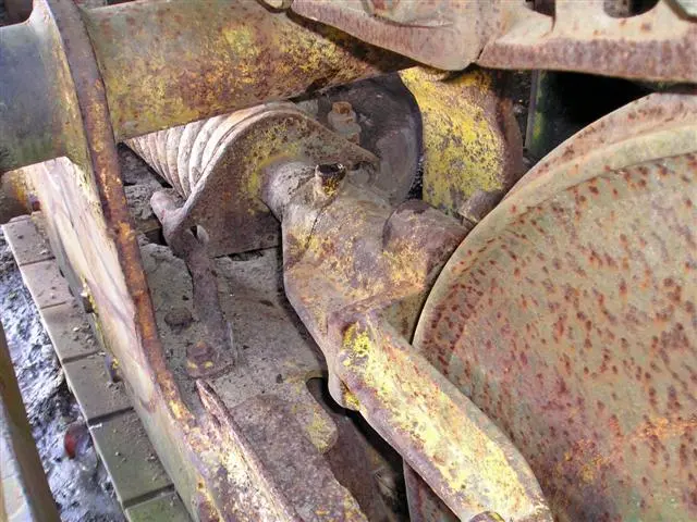

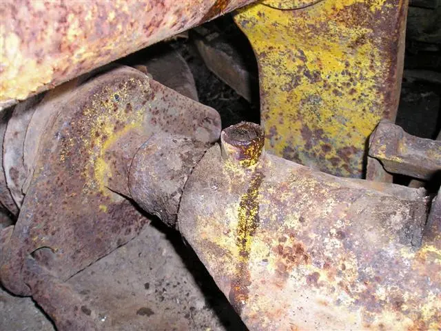

I have a 1956-or-1957 Cat D4 7U-38165. None of the manuals I have show a picture, a parts breakdown or discuss the track adjusting procedure for these tracks. I believe them to be an early hydraulic adjuster. Can anyone help me with this? I have attached pictures of the assemblies on my D4.

Al, they are aftermarket adjusters. Maybe "Timberline" If you need a seal for them try to get hold of a guy by the handle of "Halftrack" John Hopp. He got seal for a friends machine.

Hi Al,
Ok, I'll have a go😄 😄 ....I'd say those are an early version after market hydraulic adjuster alright, prior to the Cat version coming out on the D4 at sr. # 42,915. Usually there are two grease fittings, one to pressurize and one to release. I only see one source to tap on the ones you have so I guess you make connection and pump grease in until you get the proper track adjustment (1-1/2 in.) raise over the carrier roller.

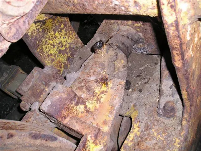

Thanks for the joint effort on the pictures😄
It's the view in picture #3 (your # 10004) that intrigues me. The brackets I have do not have that tapered (figure) shape and mine are much wider (4-bolt to the frame)
I was wondering if it was a Cat variation to accommodate the five roller frame as the five roller versions I have seen have a big (crude) notch cut in them to clear the spring when the whole mounting group is shoved forward on the frame.
See you have the direct start provision (cover plate) ready to go😊 😊
Thanks.

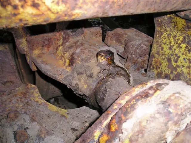

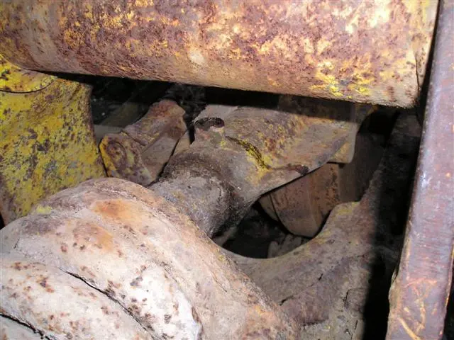

I missed one that might help, This is a 4 roller machine
