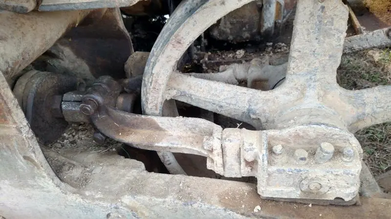

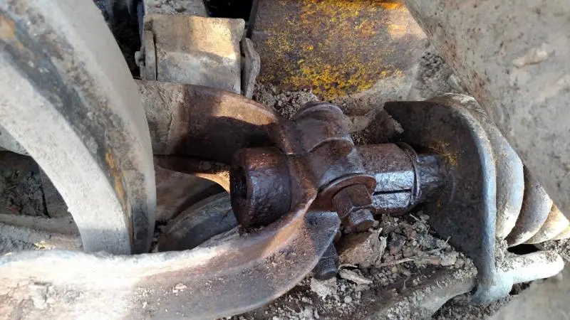

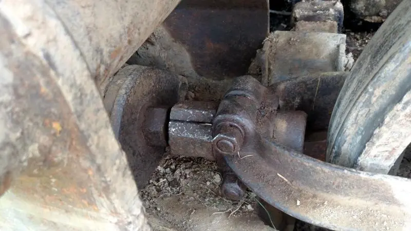

Pictures of my adjusters
Tighten idler with a porta power and fabricate shims the right thickness. Even if you buy new nuts and go to the trouble of installing them they likely will not work because the threads are worn on shaft and changing that is big trouble.

Reply to 8C 361:
or you could install a set of Hydra Justers???

Reply to 8C 361:
Second that- if the threads were usable the idler wouldn't have shims on the bracket.

Reply to STEPHEN:
Hi Team,
from memory, the spacers pictured are part of an Attachment for the larger diameter front idlers--at first thought I see no reason that thicker/more spacers could not be used to adjust track tension if the adjuster and spring center bolt threads are worn out--usually caused from excessive movement of the idler on the track frame --both up and down and sideways--due to not maintaining correct idler hanger wear plate and side plate clearances.
Operating the unit with loose idler adjuster nut clamping bolts does not help either.
