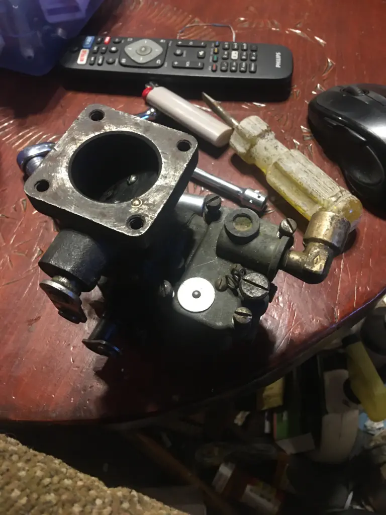

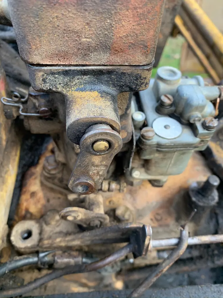

bruce oz
Posts: 1,430
Thank you received: 21
 [attachment=66550]carb1.JPG[/attachment] [attachment=66551]carb2.JPG[/attachment]
Fri, Jan 28, 2022 10:39 AM
GrantJ
Posts: 792
Thank you received: 7
Reply to bruce oz:
I had the carb off of my 6U a couple of times recently. After fighting with the nuts, I removed the governor to get to the outside bolt. Cat did not make it a user friendly job. Crows foot wrenches are needed for the inner nut. Fun, fun ,fun! Grant.

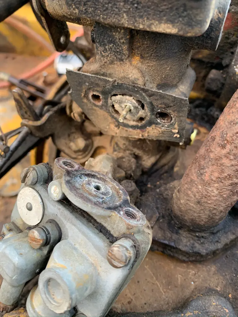

Outbackrider
Send a private message to Outbackrider
Posts: 56
Reply to Fat Dan:
[quote="trainzkid88 post=235375 "]cat still have gasket kits for those carbs.
ours needed new butterflies too.
check the choke and throttle shaft bores for play if loos either have them machined for bushes or add a o-ring to each end to make a seal the wear can be a cause of hard starting.
the best way to clean them is to sonic bath them. it's worth the $ at the local mower shop to get it done.
 [/quote]
Thanks trainzkid88 that's good to know ... I had gotten mine before I knew how to SIS over on Cat.com
 [attachment=66631]B3749955-40DA-4A2F-ADBA-95D7593F8BA5.jpeg[/attachment] [attachment=66625]CDD885A6-6CE2-4871-BCBC-A7F8218758A0.jpeg[/attachment] [attachment=66624]7AEF276A-841E-4311-8B5E-3450505404E9.jpeg[/attachment]For me, I found removing the gas fuel bowl allowed the easiest access to remove the 2 nuts holding the carb onto the starting engine. Remove the 2 screws that hold the bowl on, and gently pull the fuel bowl horizontally as mentioned earlier. You can see the corroded long brass jet tube that connects the bowl to the carb in my photo (photos posted in reverse order) I had to replace my jet, it was toast, the jet is still available.   Once all cleaned up and all passages cleaned, (there are good posts in the forums on how to clean the passages)  I reattached the carb body and then reattached the fuel bowl right on the starting engine.

outbackrider
I have found a trick to helping R&R the float bowl by taking the two screwcaps (bolts) that hold the float bowl down, if they don't have them, make slots in the tops of the bolt heads for a common screwdriver.
