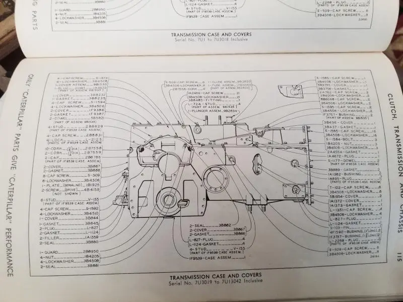

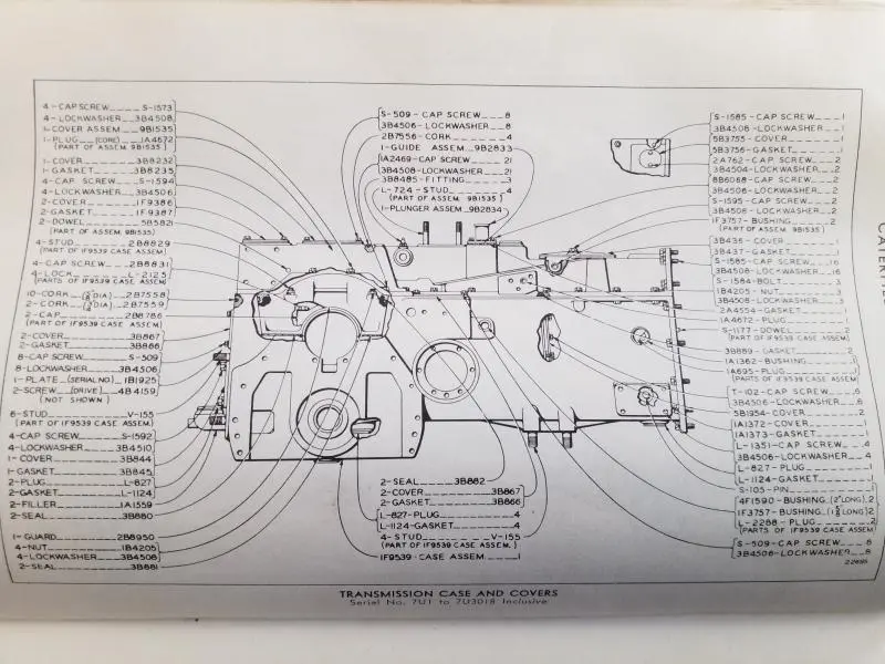

Does someone have the part number for the cork gaskets that go under the steering clutch assembly and seal the cover over the ring gear. I had the book 2 days ago and now I cant find it! Thanks guys I appreciate it.

From parts book 7u1 to 7u27569
[attachment=54201]20190605_114123.jpg[/attachment][attachment=54202]20190605_114214.jpg[/attachment]

I think you need 3b881 and 3b882 for the ring gear cover
This is the only section in the parts book with the transmission housing
Hope this helps
