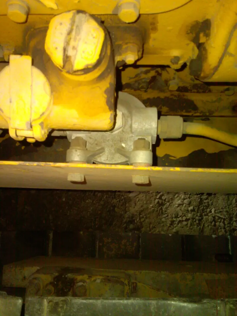

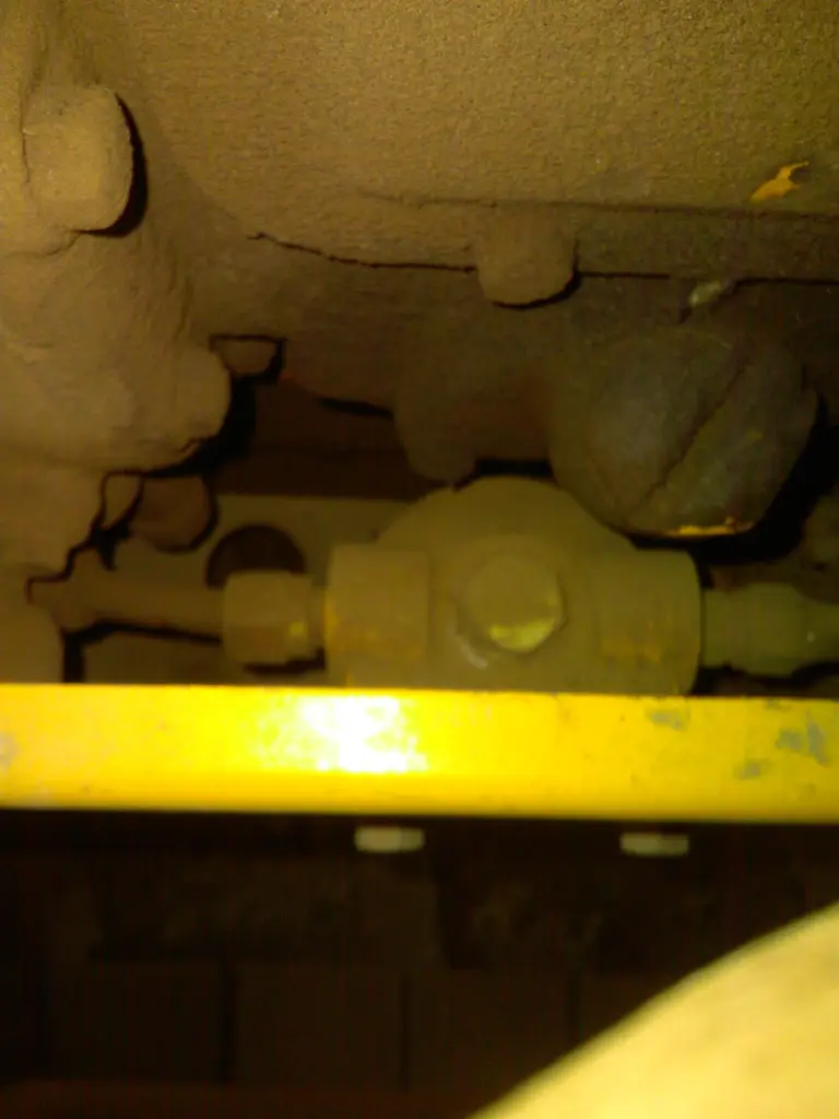

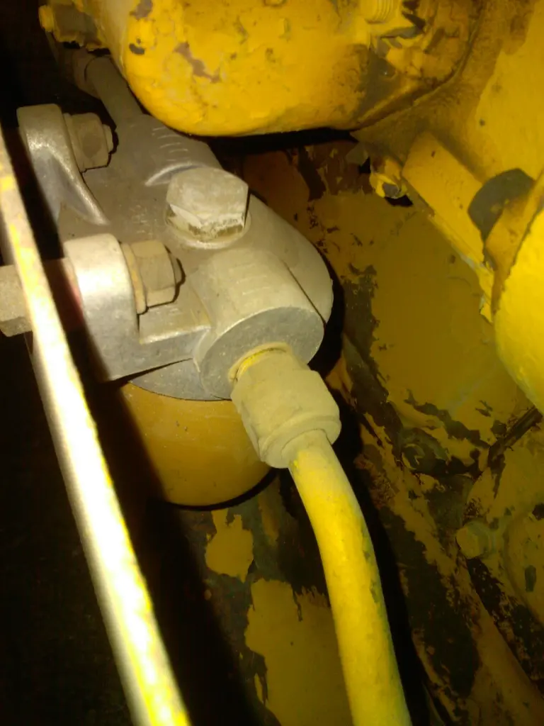

Gary,  Do you have any pictures of your filter mounting?
Fri, Oct 22, 2021 8:39 PM
Filter on my 5U D2. another photo on next page.
Sat, Oct 23, 2021 12:42 AM
Filter on my 5U D2 and one pic on 7U D4
Sat, Oct 23, 2021 12:44 AM
