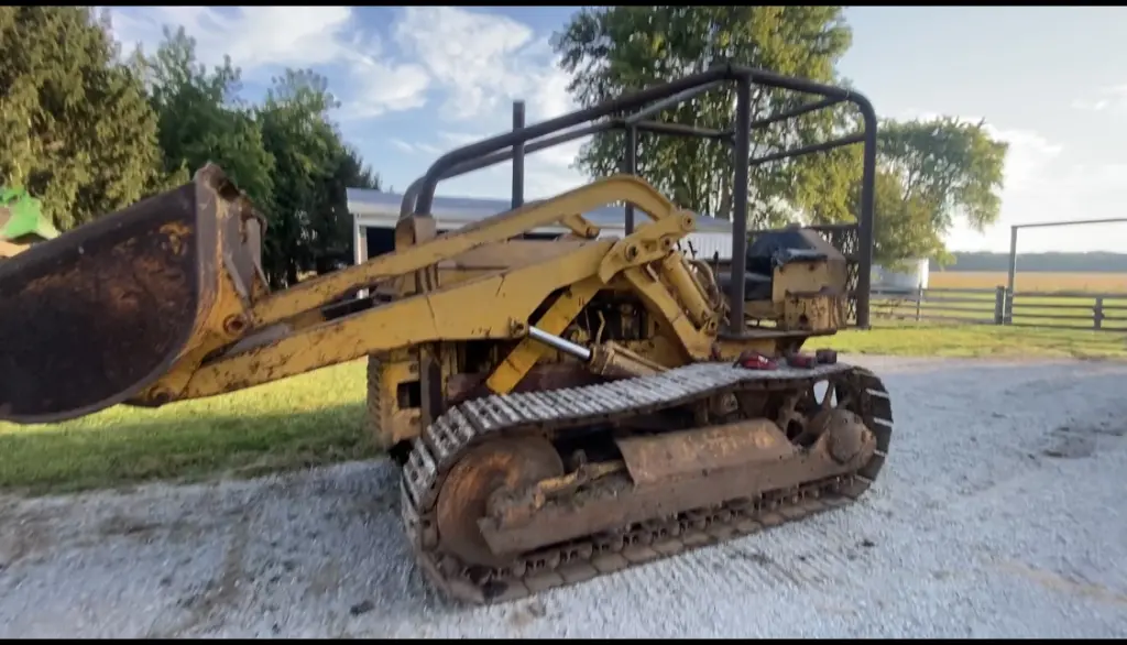

 [attachment=64670]94F1A817-3ECC-4D4E-A17C-FC529E147AFD.jpeg[/attachment]
Looking for anyone who has converted a D4 to direct start.
I feel like I have found most of the information needed but I have a few questions.
Who sells the correct bendix gear?
Is a 12v 42mt starter adequate?
Found a template for drilling housing, anything I’m missing?
Any good write ups with pictures?
Thanks!

Welcome to the Bulletin Board. That is a very clean looking loader.
"Old Magnet" are you out there? This is right up your alley. Perhaps a few points of wisdom to share?
The biggest issue I notice is, it being a loader unit, I am guessing the engine or the loader needs to come out to do your conversion due to lack of space. Ugh!
I have seen your question posted on FB pages. Have you looked into why the pony will not run?
Hopefully somebody will chime in and get you headed in the right direction.
Thanks for the photo. Always good for attention! JM

Juiceman, thanks for the reply.
I believe I can drill the required holes with engine in place. I plan to build a template in my shop based off of Old magnets information from web.
Pony motor has not run in many years. Magneto was full of water, gas tank is missing and oil is mostly fuel. For the cost of new magneto I can buy 42mt starter and bendix from local starter shop.
I still plan on starting from standing on the side to utilize decompression lever and prime fuel/oil systems.
I’m pretty sure I’ve got most of the theory figured out just wanting input before I proceed, haha.

Most direct start D4-D6 use 24 volt starters, at least the ones I have operated.

yes it will be costly to rebuild the pony and the mag, but it has advantages especially in cold weather and when it comes to bleeding the fuel system. yes they can be cantankerous to start. but there are advantages. try and locate a running pony or one that doesnt need rebuild.
i know of some that have both.
and 24v is always better than 12 as it has more power. other advantages include more availabilty of parts and cheaper wiring. remeber a doubling of voltage halves the current draw for the same output power.

trainzkid88, i was thinking staying 12v would keep things simpler.
Loader will be used only on my farm for a pond and some trails. I bought it for scrap price and honestly im going electric start for the simplicity. I figure i can swap the electric start into it now and always rebuild pony at a later date.
I was thinking a 12v intake heater (like cummins use), and a 120v block heater for the colder days.
Stopped into local starter/alt shop and he will have12V MT42 starter and correct 12t 220-12190R bendix tomorrow.
i suppose you could use a parallel switch to utilize your 6 volt charging system to charge two 6 volt battery and then start on 12 volts????

you can use a thermostart in the intake manifold for heat during starting.  i think the thermostart plug cost less than 20 dollars

yes 24v is better electrically but 12 is very common. and you can use the 6 volt generator to charge a pair of 6v batteries that are linked in series via a soleniod to become 12v. it would be simpler to do what i have done and turn the old generator into a layshaft to belt drive a alternator. i simply had a longer shaft made and fitted new bearings to the generator housing yes you could also skim the generator end housing shorter so you can fit a pulley to the armature shaft.

Zzzop, a 12v starter is plenty adequate, while a 24v will make it seem even easier. One of our old logging trucks contained a 903ci Cummins, which is considerably larger than the D4's engine and the 12v starter in that engine had no issues starting the engine in the dead of winter. It helps obviously that the 903 is direct injection and there are more cylinders to help get going but applying external heat like you're planning is the key to easy cold starts even on old clunkers like the D315. The block heater on my F350 makes starting it in winter just like it it was already running and warm. Just make sure you don't skimp on the battery cables. Use 00 cables, new clamps nicely soldered, clean and bright connections, and you won't have any issues.
I contacted a starter motor guy about building a 6v MT style starter for my 5U. He was quite interested in it and I really must get around to following up to see what size cabling I'd need. Existing cabling is 00 to the pony starter but the current draw on a 6V MT would be easily double that I'd say. I have a single 800CCA battery currently : ), and could easily fit two. My idea was to use the 6v starter for when I "accidentally" stalled it on the heap at the show in front of a bunch of girls, so as to save some face! I think it would have just enough to start the main when hot, and after getting it spinning over on no compression. All of this is just so's I don't have to replace the 6v generator. It's not the best technical solution obviously but it's one of those "I wonder if it would work" scenarios.
