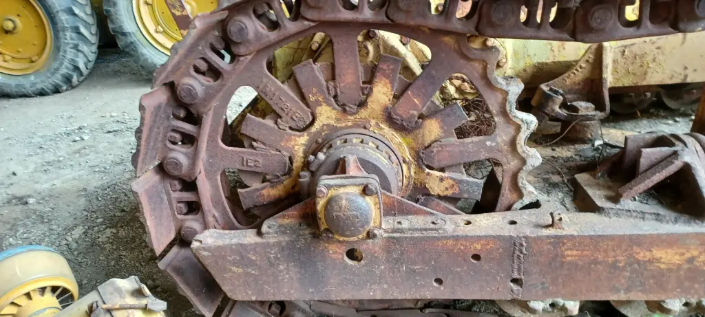

Hi Team,
Speaking of welded sprockets here is a humdinger I saw last week--or how to keep this T4 Shovel running a bit longer.
Tue, Dec 14, 2021 12:34 PM
Posts: 16,783
Thank you received: 46
Reply to edb:
Hi Team,
Wow!! and to think those welds are holding????

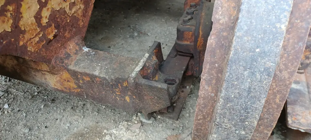

To fit that fine mess they cut the track frame rather than removing it, it looks like. A bit better weld but still not something to brag about.

Hi Team,
the machine looks to be an incomplete early Trackson but could be some other brand unit as it has chain drive to the overhead winches. It has the loader frame bolted to the track frames in weak areas.
There are bodged repairs and additions every where.
The current owner said he may yet be resurrecting it enough to show its history of abuse and bush repairs.
Wed, Dec 15, 2021 6:44 AM
