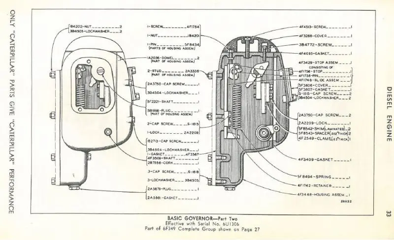

pulling off the govener helps with 2 things.
firstly it helps you get to the back of the injector pump to undo the 3 mongrel studs
and secondly its a bloody heavy to lift leaning over tracks lifting the whole pump off so removing the govener makes it a tad lighter.

1 x 4f3367 - gasket for Goveneror if your going to remove it.

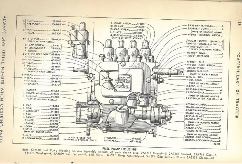

Here is a picture of the seals and gaskets required... the fuel injection pump assembly and govenor together weigh 80 pounds... best to utilize an overhead lifting device if you can because lifting that much while bending over the track is tough.

I checked the tell tale lines last year and they were free and clear so i think its got to be the orings and gaskets you guys are talked about Thanks 👍 Im a smaller guy so i can stand between the track and tractor with room to spare so it shouldnt be to bad for me. I figured something big was going to be up as when i went to use it first time this year the tank was empty and the motor was full. i drained it all out hoping it would just be a small leak but its fairly big and needs to be addressed.
