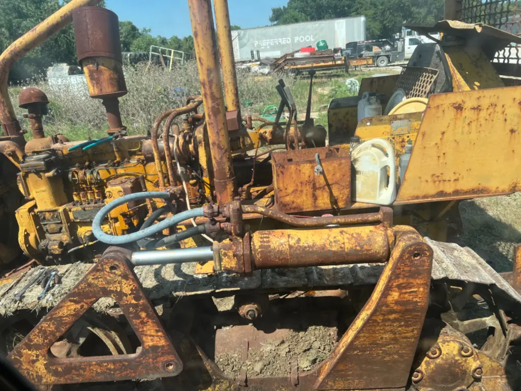

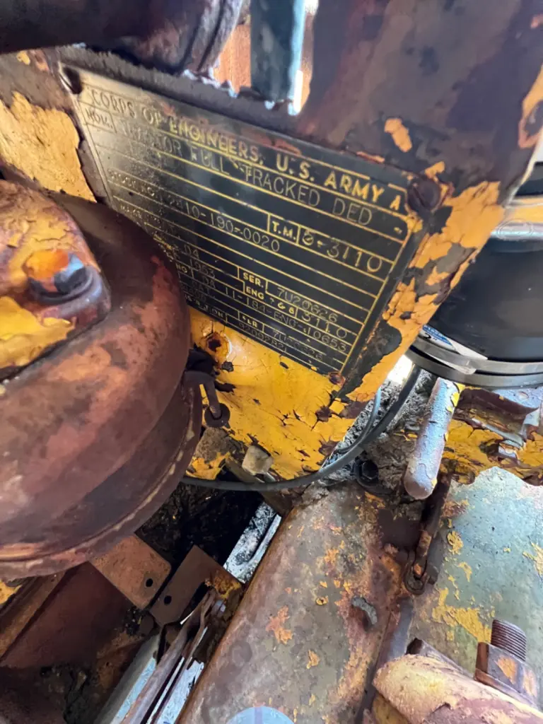

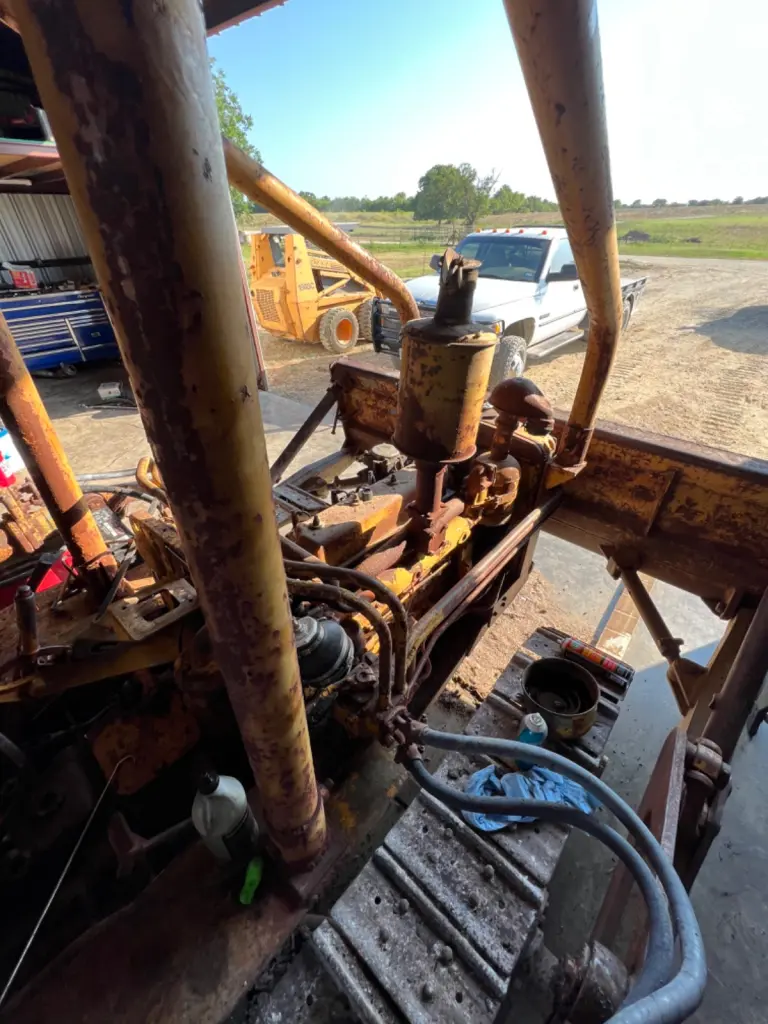

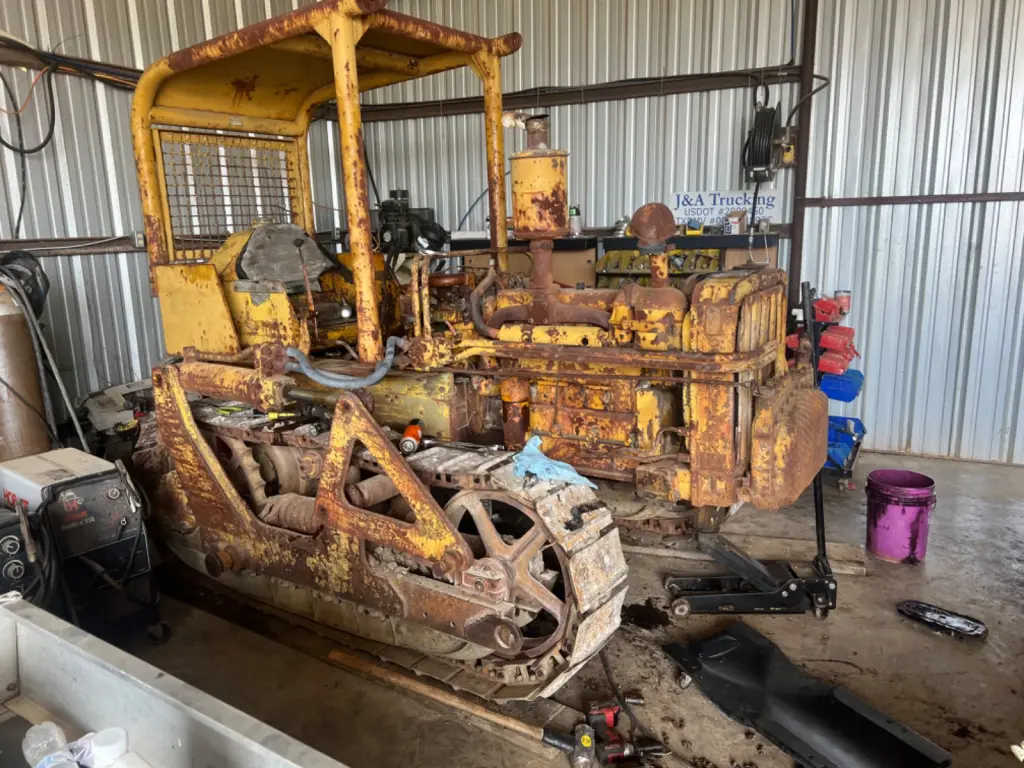

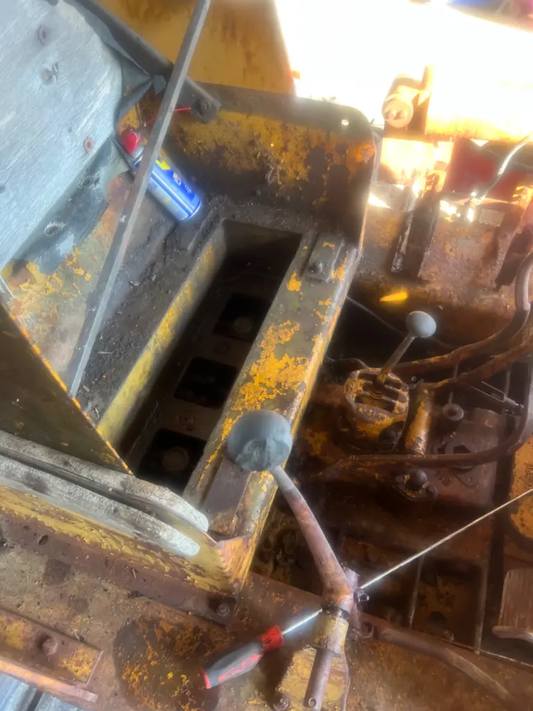

 [attachment=73036]1DDD213D-8122-4374-AAFB-9839B55C6B26.jpeg[/attachment] [attachment=73035]6E7D5F5E-538E-4AF8-8AA1-4B4494E74C7A.jpeg[/attachment] [attachment=73034]58E5B933-BB11-419A-9E12-82AFFEE0060A.jpeg[/attachment] [attachment=73038]23084DCB-1428-409F-9530-4B514FD38F9F.jpeg[/attachment]Need help identifying if this configuration looks correct to anyone else radiator cap style and engine style remind me of a early 5j D2 but data tag says otherwise and dash looks like it has been butchered to fit application at some point???? [attachment=73037]6A524739-1586-4F76-B085-C278C1C31FF9.jpeg[/attachment]

Looks to me like you have a D4400 engine on that tractor, given the location of the air cleaner. That would explain your observations. The rest of the tractor is looks like a U-series. It's not uncommon to find combinations like this, as the engines were basically interchangeable between the U and J and earlier
you have a hienz machine its unique.
