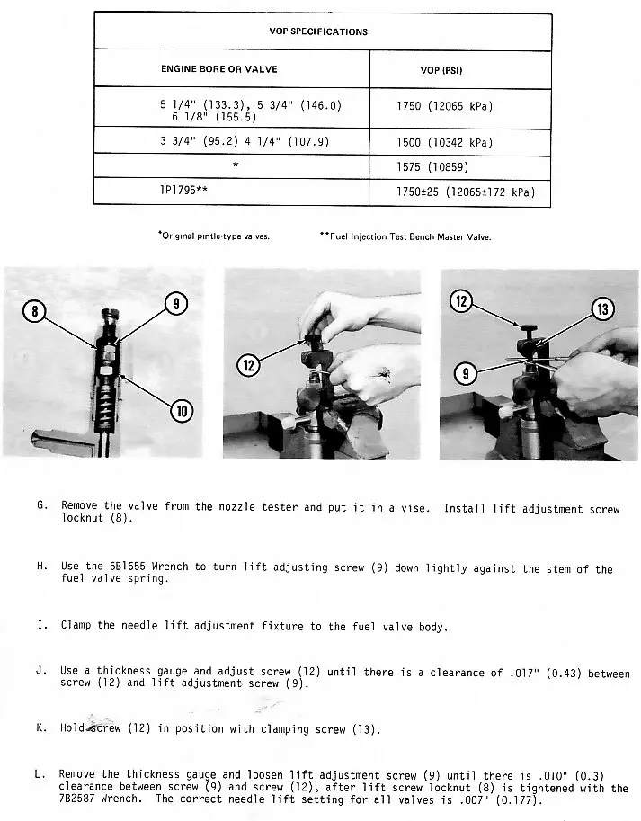

Hi new to the page is there a way to take injector apart like a guide to clean it and what PSI on an injector test should it read for it to function ? Thanks for any help

Welcome aboard Halfthrottle! There is a copy of the Serviceman's Reference Book for the D4 7J Form 7490C in the ACMOC library. You will find your answers there. Thank you for joining!

Flat seat injector adjustment procedure..
 [attachment=73814]Flat seat press adj #1.jpg[/attachment]
[attachment=73815]Flat seat press adj #2.jpg[/attachment]

Thanks for the help
