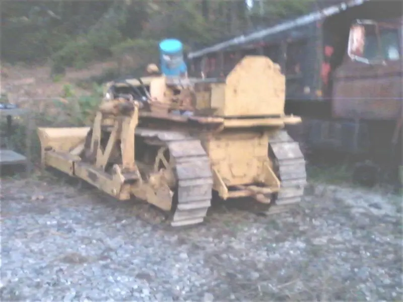

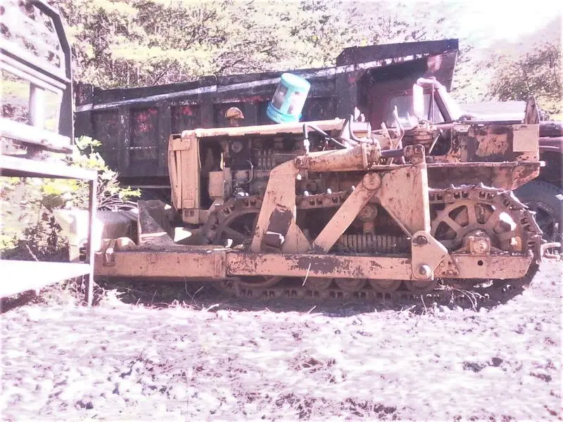

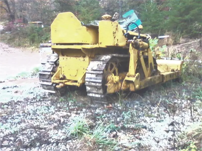

I recently traded for this old D4, which I owned several years ago. The fellow I sold it to let it sit and didn't use it. It's been around 15 years since it last ran. Both engines are loose, and the steering clutches seem to be loose, but the main clutch is stuck. What would be the best way to get it loose? I appreciate any replies.
