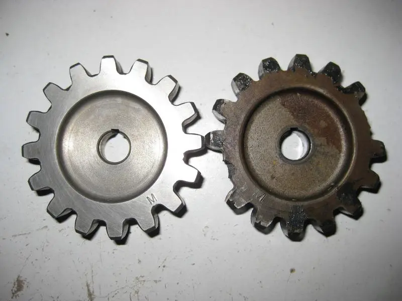

Now the pony motor has been pulled off the dozer and is sitting inside and we ordered all the parts we thought we'd need. I just have one question, we received the new magneto gear and the magneto timing mark is in a different place to the old one so we are thinking that maybe the old gear was positioned wrong and that's why it wouldn't run correctly but we are unsure.
[attachment=20277]IMG_1372.jpg[/attachment]
I am just wondering which timing mark to believe.

The main issue i'm having here is that if you look at the attached image in the first post the new magneto timing gear has the 'M' mark in a different position in respect to the keyway compared to the old gear. We have no idea which timing mark to go by.

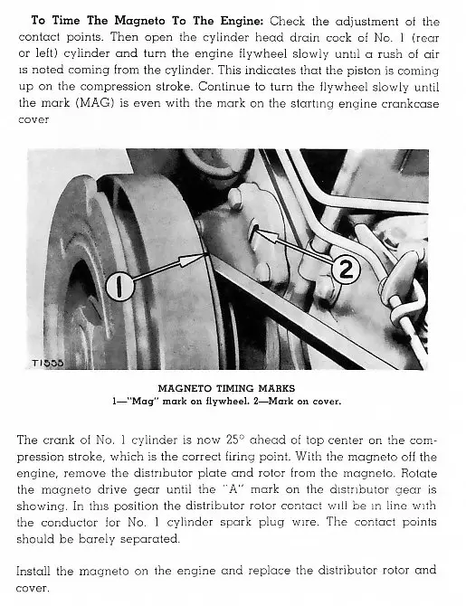

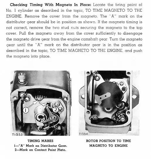

MMmm, maybe left/new gear is a chinese gear with the "M" mis-stamped to 8 O'clock position instead of 4 O'clock as per old gear.
You could time it the way shown in the scans below.
Thanks Eddie, I'll take those in and see if we can work something out. The new gear is a genuine cat part 2A4144.

Alex,
sit the gears on top of each other and confirm that the teeth line up with the keyways also lined up. From there it's just a matter of deciding where the right place for the letter M is (can't remember on mine....)
