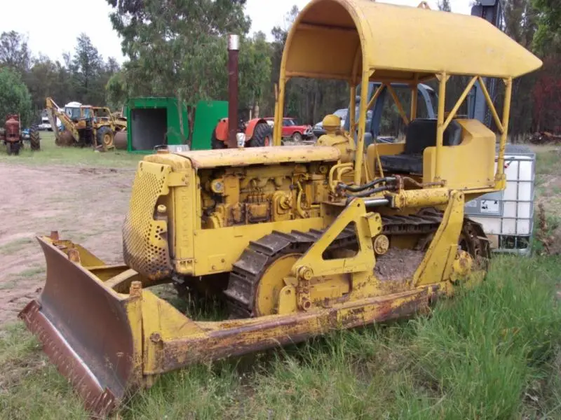

Hi,

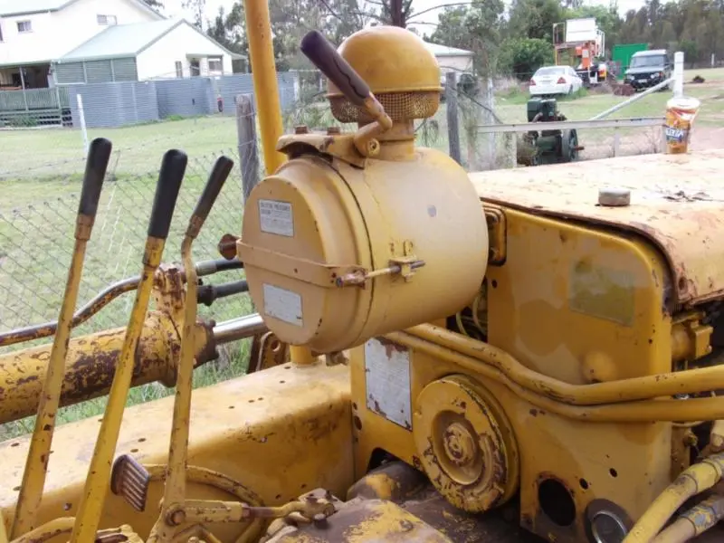

I am new to this forum and have just obtained a 6U series D4 Serial number is 6U8564. This plate is on the engine and the frame plate is missing. I wonder if the engine has been changed at some time. It was origionally a side tank model and early in it's life, a custom made seat tank was fitted to give extre fuel capacity and a Cat dry type air filter fitted.
Does anyone know of other detail that could identify the age of the tractor?

D4 6U8564 is 1953 production. You should find a matching number stamped on the rear of the tractor but it may be buried in paint.

Look above the left cover on the rear of the tranny for 4 small holes or broken rivets. Usually the s/n was stamped there before the tag was put on. You might have to scratch some paint off but that's where the numbers ought to be.

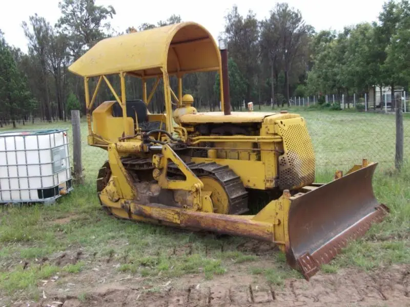

Hi Neil,
The only photo taken at home was the unloading. The others were taken where I inspected the tractor out on the Darling Downs south of Dalby. I am located in the Toowoomba area.
Most dozers here were fitted with bush canopies and many also had down bars from the front of the roof down to the radiator and heavy mesh on the sides to give protection when clearing bush for farming.
I found the 4 rivets, now have to buff the paint back to look for the stamped numbers

Hi, Aussie John.
Nice catch and it looks in reasonably good condition. Somebody put a LOT of work into that fuel tank and also into the canopy. Way too many canopies were made with little or no overhang at the back to protect the operator from objects sneaking up - or down - from behind while he/she was looking up front.
Unless I miss my guess, it also had a tree pusher going by the risers just in front of the blade lift links.
If it is the original engine, the serial numbers should match. If they don't, it's likely been re-donked at some time. A rotary wire buff should do the job nicely.
