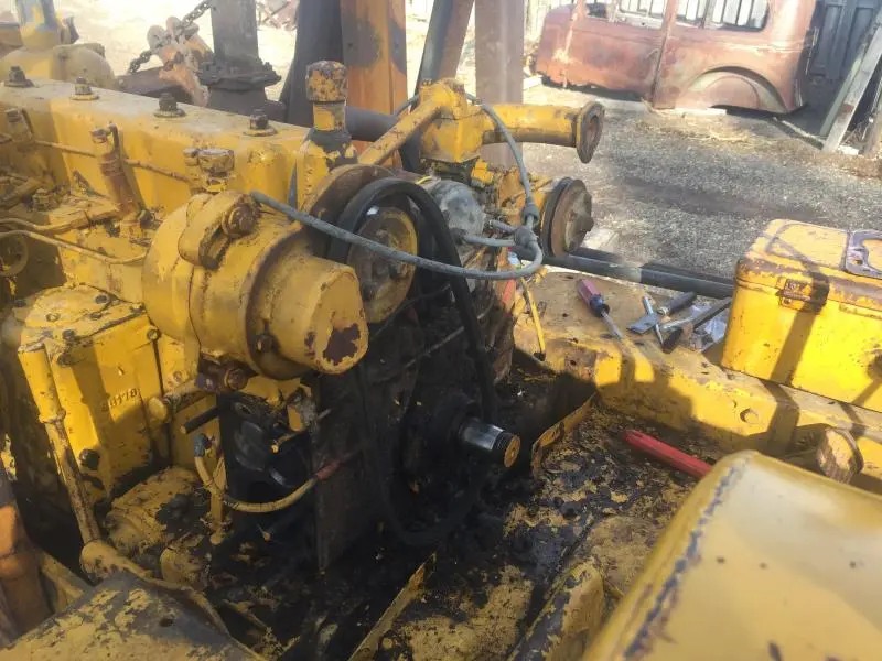

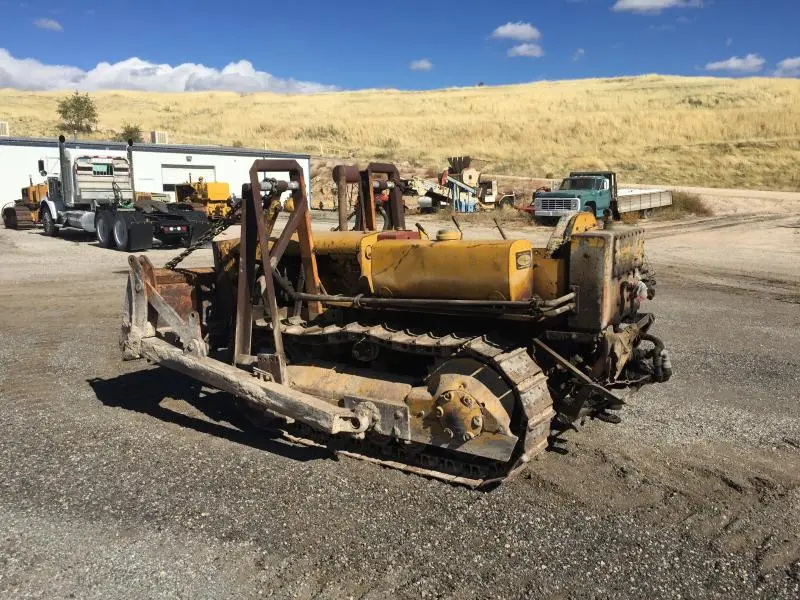

Heres a pic to give y'all a idea of what i got. The dozer frame is getting a rework asap!
Fri, Oct 20, 2017 11:14 AM
[quote="Youngfordkid"]Hello all,
After 3 days of busted knuckles, and 2 bottles of gojo hand cleaner, I finally got our D4 pony motor up an going. It has a bit of a knock, so new rod bearings will be coming soon. I ran into a few issues with the startup of the tractor, and I have experience with our 2H D6 starting sequence and how "smooth" the pinion engages and what not. On the D4, however, it is a little more worn out, and just "tired".
So on for the questions:
1) how is the best way to adjust the starter pinion clutch?
NOT TOO EASY ON THE ONE YOU HAVE WITH JUST A PLUG TO SCREW OUT. IT CAN BE DONE IF YOU KNOW WHAT YOU ARE DOING. LOOK UP THE YOUTUBE VIDEOS SHOWING THE MECHANiSM POSTED BY SASQUATCH, A MEMBER HERE. NOTE, THE ONLY ADJUSTMENT IS TO THE CLUTCH, THIS DOES NOT NEED MUCH OF A SNAP TO PULL THE DIESEL JUST FINE.
2)the pinion does not like to stay engaged when turning over the diesel. I know it could be worn pinion latches, or my pony could be spinning the pinion too fast, thus keeping the latches from holding it. When i hold it in to keep the diesel rolling, it feels rough, and defininitely not smooth.
IT IS PROBABLY FFEELING ROUGH BECAUSE THE ENGAGEMENT FINGER AND BUTTON ON THE PINION ARE GETTING DAMAGED BY HAVING TO HOLD IT IN ENGAGEMENT. NORMALLY THERE IS NO ROTATION WHILE YOU ARE DOING THAT.
3) what are your oil reccomendations for the pinion clutch? Ive heard ATF is a favorite, but what have y'all found works best?
ATF IS A GOOD SOLUTION TO ONE THAT IS VERY HARD TO BRAKE THE PINION AND KEEP FROM GRINDING AS YOU ATTEMPT TO SHIFT THE PINION. IT LESSENS THE DRAG BETWEEN THE CLUTCH DISKS CAUSED BY OLD SLUDGY MOTOR OIL. PROBABLY BEST IS TO FLUSH THE COMPARTMENT WITH DIESEL AND REFILL WITH CLEAN OIL.
4) would putting Lucas oil additive in the pony be detrimental? The lube system is splash, and i want to make sure I don't inhibit that from happening if i "thicken" the oil with an additive.
THE NORMAL PROBLEM WITH PONY OIL IS BEING THIN FROM GASOLINE DILUTION. ALWAYS SHUT OFF THE GAS TO THE PONY AND I LET IT RUN UNTIL IT QUITS TO GET AS MUCH OUT OF THE CARB BOWL AS POSSIBLE.
5) what would be the best oil to use in the Diesel engine? Right now i have a 5 gallon pail of Sinclair 30 W standard motor oil. Would a 10-30 delo be a better choice? ( I don't want to spark a oil controversy)
THAT IS A GOOD CHOICE. DELO OR OTHER QUALITY MULTI-GRADE DIESEL ENGINE OIL WILL PROVIDE GOOD SERVICE AS WELL. MIGHT EXPERIENCE LESS OIL CONSUMPTION WITH THE STRAIGHT 30.
6) is there a cross reference for the oil filter to a Baldwin/Hastings number?
YES, BUT FIRST NEED TO KNOW WHAT FILTER YOURS HAS ON IT. TAKE IT OUT AND TAKE IT IN TO CROSS IT OVER. IF YOURS HAS BEEN CONVERTED TO FULL FLOW A WIX 51161/NAPA1161 IS YOUR FILTER. HOWEVER YOURS WOULD HAVE COME FROM THE FACTORY WITH A BYPASS FILTER THAT YOU WOULD RRECOGNIZE BY IT HAVING A WASHABLE BRASS SCREEN ON THE DISPOSABLE FILTER INSIDE
I really appreciate the help from this forum and from ACMOC in general, so even if you don't have any answers, thanks for at least reading my post!
Thanks,
Wyatt[/quote]
Sorry about the all caps, its just the best way I could keep the responses separate from the questions!
Your pony sounds like it is in danger of grenading! I would not keep running it, oil additive or not. You may find that the crankshaft has already been turned to an undersize so check dimensions carefully before you assemble it with the new bearings. Lots of them have been overhauled in the 70 plus years since they left the factory.
Probably your best option is going to be pulling your pinion and inspecting the latches and latching "nut" shoulder for wear etc. If you keep using the lever to keep it engaged you will likely end up having to split the tractor to repair the engagement mechanism. Of course if your pony is overspeeding, fix that by adjusting the governor spring tension before you go farther into it.
Fri, Oct 20, 2017 9:00 PM

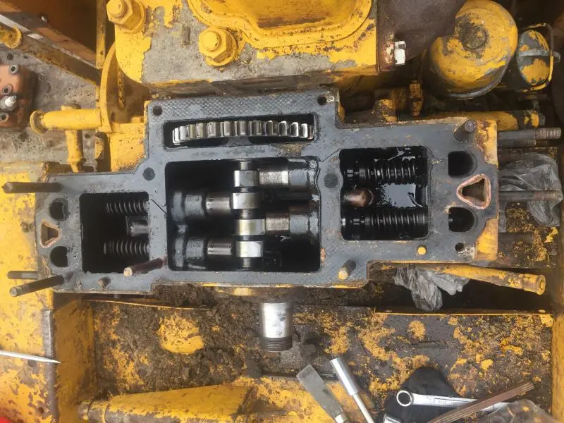

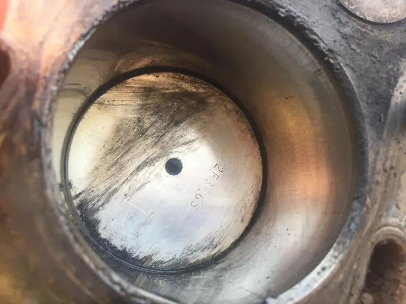

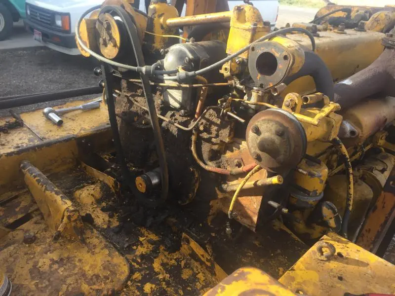

So Saturday was filled with the adventure of pulling the pony motor off the tractor, which was a little easier than on my D6. I have determined that the rear main bearing is shot in the pony, the flywheel side seems ok, but I haven't taken precise measurements yet. I was surprised on how clean things are inside the engine, but the water passages in the bottom of the cylinders are plugged along with the return on the diesel, so that will have to get flushed out.
I did find out why the starter pinion would not stay latched, the bolts holding the sleeve on to the gear came out, it doesn't look like they destroyed anything, but I didn't get a chance to look very close either. I did fish out one of the bolts through the drain plug on the bottom of the clutch housing.
So to fix the starter pinion would it be recommended to pull the clutch housing top half, or pull the governor off the diesel and go out the front?
Here's a few pics.
Thanks!
Wyatt
Here's a few pics.
Thanks!
Wyatt
[attachment=45208]IMG_0088.jpg[/attachment][attachment=45209]IMG_0091.jpg[/attachment][attachment=45210]IMG_0092.jpg[/attachment][attachment=45211]IMG_0093.jpg[/attachment]
No need to remove the governor on a 5T.
Mon, Oct 23, 2017 6:48 AM

Posts: 16,696
Reply to Youngfordkid:
Hey oldmagnet,
I am not quite sure how you would it out without removing the back of the governor housing, perhaps I am missing something? If there is a method to it, could you please explain?
Thanks!
Wyatt
The pony starter mechanism should clear below the governor on the D4400. It's the later D4's that have the clearance issues although some folks are able to remove them without removing the governor cover and some can't. Also helps if you can engage the pinion to shorten the overall length although that can be a problem if it will not latch. In your case if the engagement sleeve is detached that shouldn't be an issue.
Mon, Oct 23, 2017 12:27 PM
