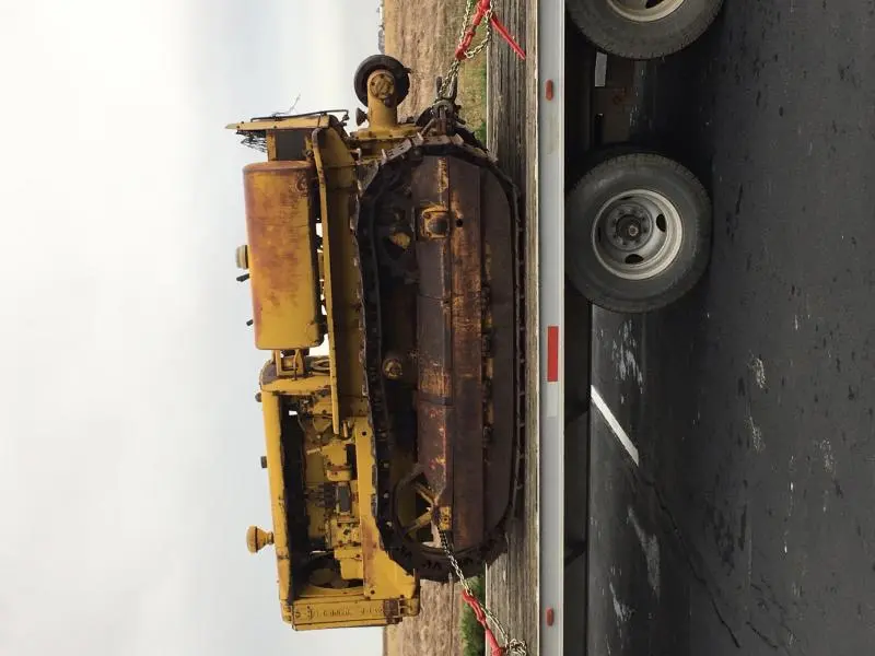

Hi all, new to the forum but not new to mechanic'ing. I picked up this D4 last week from a guy that has owned it since new. His family farmed with it back in the day and its been moved around for years and he got sick of it being in the way. My gramps farmed with a D7 back in the day (which is what I was hoping to find) so I thought it'd be neat to have one around and kinda take him back. He was glad to see it when I got it home. But back to the machine, I'm pretty sure the main engine is locked, when i got it off the trailer I tried pushing it in gear with our 15K lb fork with no luck. I have the crank but its been sitting long enough some rust has formed around the housing and made it not fit anymore. The guy thought its been 10 years since its ran. They had filled the main engine full of diesel to hopefully avoid it locking up, but he didnt have the exhaust capped the best. The old soup can over it didnt cover very well. There is a mouse nest in the manifold and some surface rust. I haven't confirmed its locked with rust as if they filled it with diesel it could be hydro locked as well. Tracks and rails seem to be in good shape though.
What are some things I should know about this tractor? It is the ag cat as the front wheel is smaller than the rear, and it has the belt pulley. I dont know a lot about the pony motors, looks like just a rope start 2 cyl engine but I have heard they can be very tempermental. Where is the oil drain for it and is there a filter?
Both the steering levers are VERY hard to pull. I would assume theyre rusted but what should I look for or take apart to free them up?
I did order a operators, service, and parts manual for it off ebay.
Where can I get parts for this thing? In the event the engine is locked, where can I get an engine kit? I hear they have liners so I could do an inframe on it if the block is in good shape.
Thanks for any help, I have a cat 22 but it is nothing like this thing. I need to gain some knowledge.
