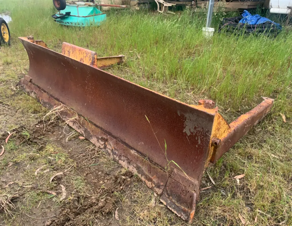

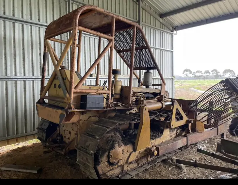

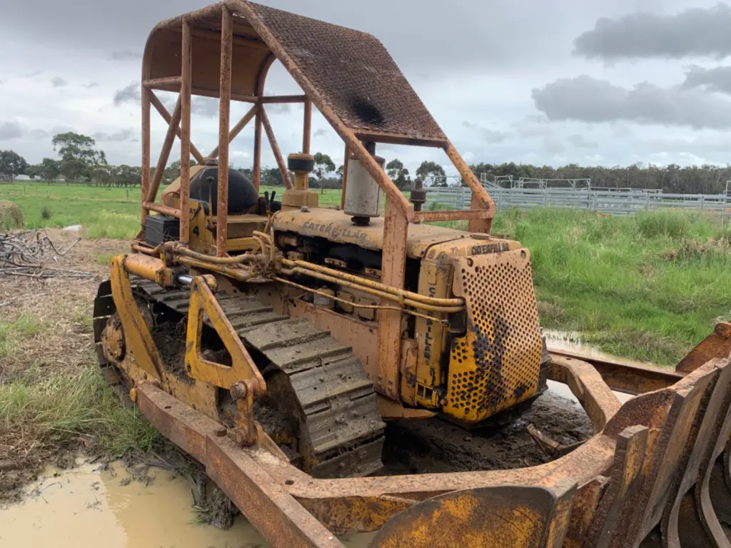

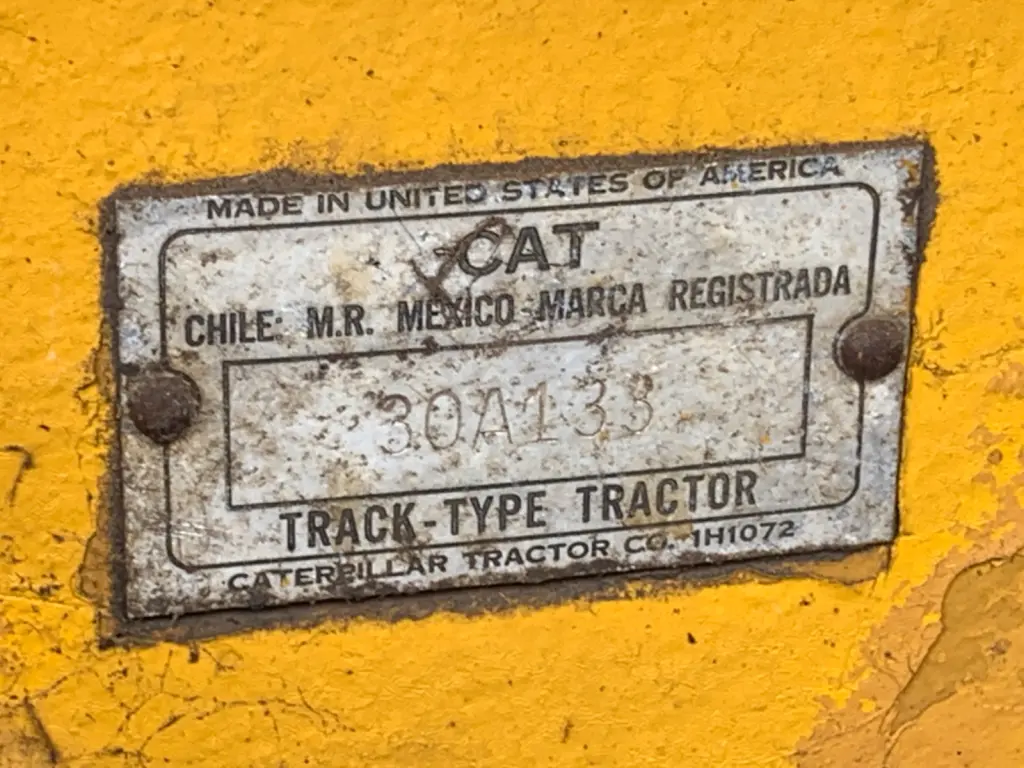

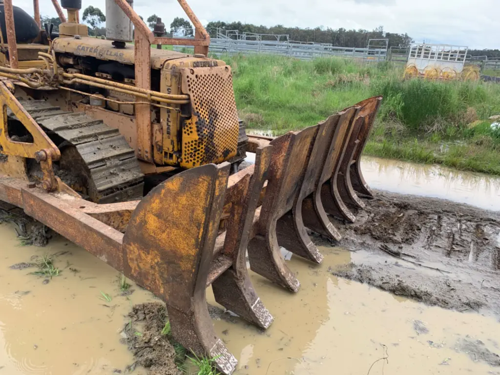

New member here.  I have just purchased this D4 30A. S/N 30A-133.  The Dozer is in very good running order.  Track links have been replaced less than 500 hours ago, as well as sprockets, final drive bearings and idlers.  Carrier roller and track rollers have also been replaced.  Paint is a bit rough, and pony motor is currently not running.  It has compression, but is missing magneto switch. It has been converted to 24v start. The wear on the track rails and bushes is less than 19 thou from new specs.  It will need new or refurbished gauges. Clutches and brakes seem to be good.  Has a home made stick rake fitted, but also comes with standard pusher (manually adjusted) blade that will need a new cutting edge.

- Been used occasionally since to clear scrub, currently has 6700 hours.  Previous owner fabricated scrub canopy.

cover those rams with canvas tarp or get a old tractor tire tube slit it on the inside dia and cut into suitable segments. those rams are not a cheap repair if the shafts are scored or pitted have new shafts made using the existing rod ends to re-chrome is over $700 bucks each. reshafting is about half that.

also make a couple of wood wedges to support the pilot engine fly wheel while working the machine they have a habit of walking through the crank bushes. also fit a rain flap to the small exhuast pipe especialy as it runs through the main engine intake if it rusts out youll dust the main engine. the reason it does is it acts like a glow plug for the main engine

didnt see it at first it has a rain trap fitted check its in working order.

If you going to leave it stored outside your better off lowering the blade removing the rod pins and retracting the cylinder rather than anything Chris has suggested the reason being the oil in the cylinders will protect the chrome and if you put canvas or a tractor tire on the shaft it can cause moisture to be trapped next to the shaft causing corrosion. Usually a chrome shaft will only go rusty if it has been damaged or the chrome is worn too thin or was too thin from manufacture. My brothers Track Marshall dozers use the same type of setup for the blade and they never went rusty even after he retired from earth-moving and the machines sat for years unused whereas my D6 has rust spots on the brand new shafts I made due to the chrome being either too thin or poorly applied.

ours is out side all the time just covered with tire tubes and we have high humidity and haven't had any rust spotting in 7 years. now the tubes are not tight or wrapped around they are thrown over for a loose fit over the entire ram not directly on the shaft and open underneath so it can breath somewhat. (do watch out for paper wasps though they seen to love building under there, dad learnt the hard way once. same with the sparkplug ends on the pilot engine they bite too as they often dont have insulating boots. and the starting pinion lever is just infront and below of the plug) something about yellow paint attracts them european wasps
another idea is rest the blade on a log or hardwood blocks so the rams are held in the retracted position also keeps the blade edge out of the dirt and moisture
we also have ours parked up on some old hardwood house stumps keeps the track out of the mud too
