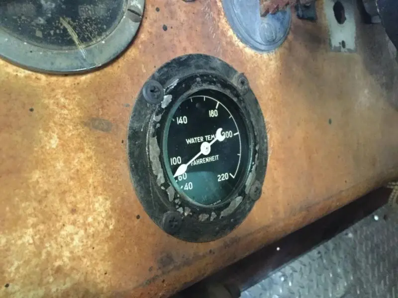

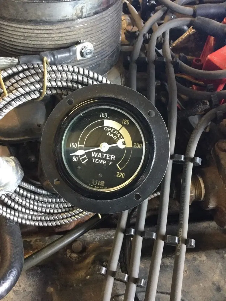

I am also working on a D4 2T and was looking at water temperature gauge options. Mine is a tail seat model so I needed a 7 foot lead to get to the dash which is moved farther to the rear than a standard D4. Most gauges are 5 or 6 foot. I found the Stewart Warner large face gauges at Summit and they had a 12 foot option. With the tail seat I have an enclosed area behind the dash to hide the extra. My plan was to have an adapter ring laser cut to mount the gauge in so it would look like the original flange mount. I also bought a more vintage looking bezel and needle on ebay. I wanted to have a custom face decal made that looks more like the original but never did. Then I found the NOS gauges on ebay and bought one. Here is the picture of the gauges on ebay for those of you interested:
[attachment=36963]s-l1600.jpg[/attachment]
I have some junk gauges that I am planning on using to transplant the correct face into this NOS gauge but I haven't gotten around to that either. The new Stewart Warner gauges have a different range than the originals so putting an old face into the new gauge wasn't going to work, that's why I would have needed a custom decal made. This is what the 2T should have, at least according to the parts catalog:
[attachment=36964]s-l1601.jpg[/attachment]
Brian
Good on you Brian for going the extra yard, I sure like that gauge with the 15 foot tube but I just can't hide that extra pipe behind my firewall unfortunately, I'm sure your 2T will look great when you finish her particularly as she is a tail seat, I don't see many of those.
Mike
