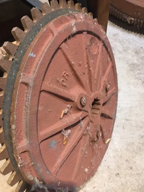

Chevydozer, it's an over-center clutch. What that means is that the links between the engagement collar (that your clutch lever pushes on) move just past "over-center" when you engage the clutch (think of a load-binder twitch or hood latch for example). The clutch is adjusted so that when engaged, the collar is just past over-center meaning that the compression on the links from going over center is not fully relieved, thus applying pressure on the pressure plate to hold the clutch closed (there has to be a better way of describing this... : ) That is, it doesn't rely on your standard spring arrangement to hold the clutch engaged, but instead relies on the spring effect from compressing those links as it goes over center. My D2 has three very small springs on the pressure plate whose job is to keep the pressure plate separated from the driven plate when disengaged, but it's your lever and thrust collar that are responsible for the actual disengagement. Ok, enough of the poor explanation; here's a couple of videos that shows the clutch disengaging and engaging (collar pushed toward pressure plate = engaged - notice how those links move just past center when engaged. They're compressed at this point and trying to release that compression by pushing further forward, which of course puts more pressure on the pressure plate holding the driven plate engaged)
Disengaging - http://www.youtube.com/watch?v=bMqMYGAJWAc
Engaging - http://www.youtube.com/watch?v=sYYlJwaUCF0
The three small springs on the other pressure plate that try to separate the three plates (two pressure and one driven) when disengaged - picture shows them (well, the rods that they bear on) compressed as the clutch is currently engaged):
[attachment=34516]IMG_2484.JPG[/attachment]

Im still kinda lost i cant tell whats engaging and disengaging i need to see how the gears or clutch is working and thanks for the reply and i have the drive shaft off now can i take it apart more to unstick this thing

Once you get it apart and work it by hand, you'll see how it works. Apologies for the poor explanation! : )
