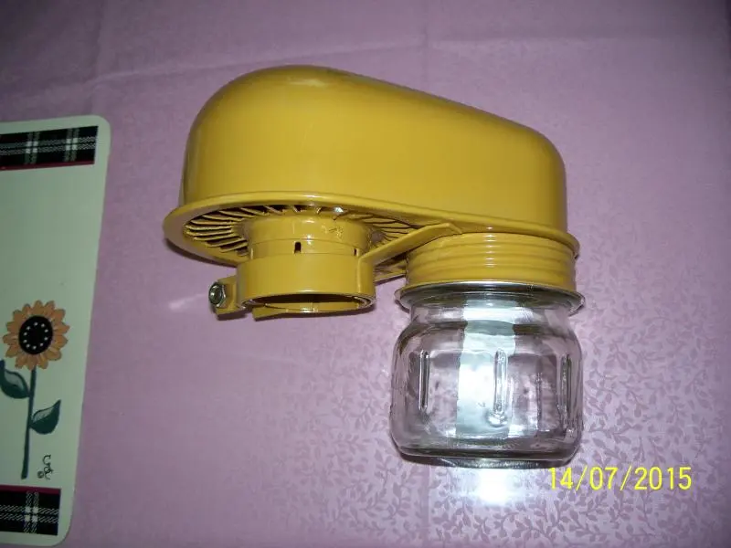

Oil Slick
Posts: 1,702
Reply to Mike Meyer:
Hi Mark, Thanks for helping out, it looks like I can buy one of those new 59096D Donaldson pre cleaners out of the USA for about $55, plus freight to Oz so add another $100, but it looks to have the glass jar, I had a feeling our ACMOC President Bruce was selling the glass jars a year or 3 back though I'm not sure if they were for the D2 or the D4, the newer Donaldson is not quite the same shape as the old D4 Donaldson so I'd be interested in yours if it is still in half decent shape, my 2T will be a work tractor not a show pony.
Mark, does that 2T wreck have a decent oil manifold pipe running the length of the block supplying oil to the main bearings, my pipe has been squashed and is only about half it's original diameter and I've been offered a manifold off a earlier model D4 but I'm worried it will not fit because Cat made several changes to those oil filter towers and I assume the oil manifold mounting plate from the RD4 through 7J to the 2T, plus that manifold I've been offered to buy has had a bodgy solder repair job in the past so there are concerns it will not repair well.
Mike
Is this what you guys are looking for?

B4D2
Posts: 1,104
Reply to Oil Slick:
Mike, you are correct. I still have a couple of the jars. They fit the Donaldson precleaners on both the D2 and D4.

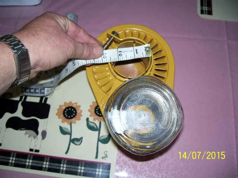

Reply to Oil Slick:
Yes Mike, that is what we are talking about, it's hard to see from 8,000 miles away but is your internal measurement of the throat around 2-1/8", because my 7J and the 2T both measure 2-1/2" external on the inlet pipe suggesting I need a 2-1/2" internal on the pre cleaner, and I reckon that Donaldson 59096D we are discussing measures 2-1/4" in the throat, looking on Fleabay it appears there are several of those Donaldson pre cleaners with jars, but maybe their 2-1/4" throat, the 59096D is the largest of that type?

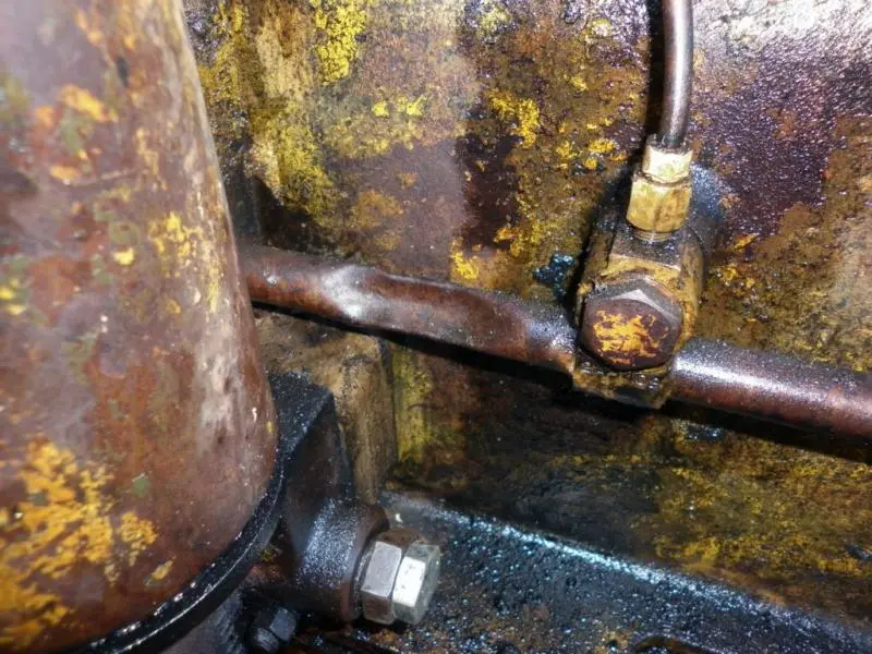

Hi Mark, this photo is of the oil manifold on my D4 2T I'm hoping to replace, do you have something better than that without leaks and bodgy solder welds all over it?
Mike
Mike
Hi Mike, Iws this what you are looking for i got this off fleabay it fits an Inter tractor
