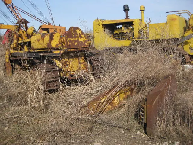

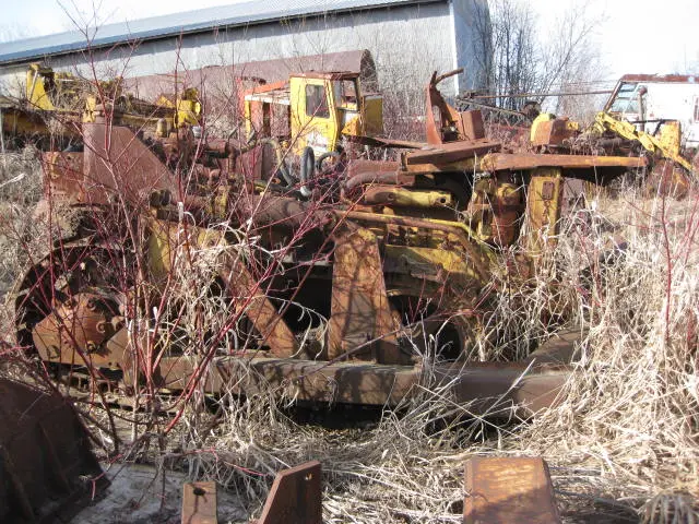

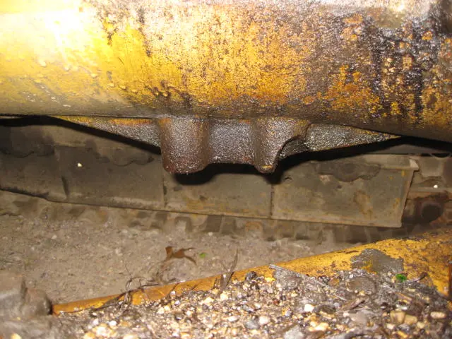

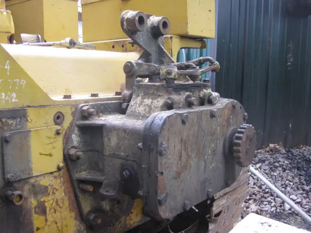

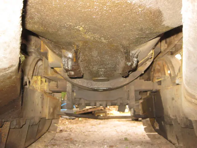

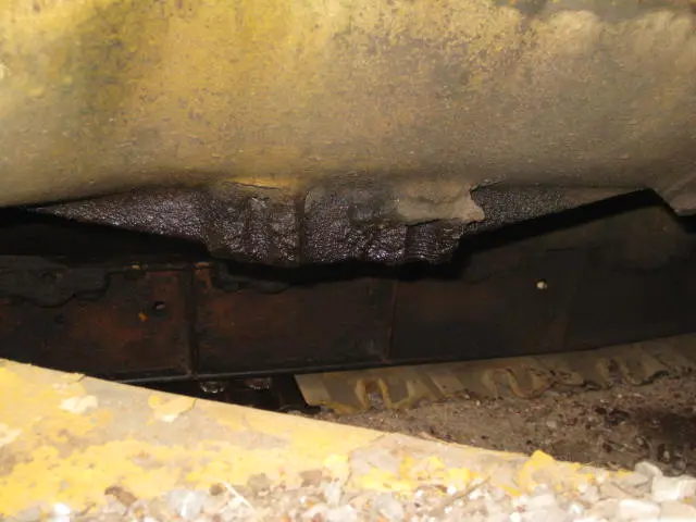

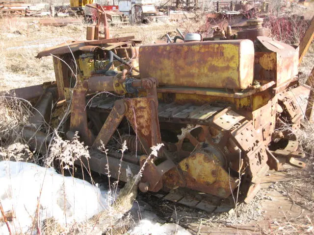

Thanks for the info guys. What I have is a D4 2T779 and the D4's I found are 5T9565W engine # 7U2083 The second is 5T2093 engine# 5T2023 The third is 7J5562WSP They are in rough shape motors are tight and parts missing. I am down to the second one as an option. One reason for the parts machine is where the draw bar bolts to the tranny housing 3 of the 4 bolts broke the casting, and if it can be fixed I wouldn't have to swap it out. The second reason is the second machine has a blade I might be able to use on my machine.
Hi, Hookblock.
That's a bit of a menagerie that you are looking at there. The 7J series is the first after what was originally the RD4 with a name change to just plain D4 during its production run. Then came the 2T and the 5T, both of which came in narrow and wide versions. These were followed by the 6U - narrow - and 7U - wide - models.
T'would appear that the first 5T hes been re-engined with a later motor out of a 7U series crawler. Nothing wrong with that, just a bit more grunt.
If your country is at all hilly, that first machine, the wide 5T - 5T9565W, would be a good one to build on, especially if you have enough good undercarriage parts. As I understand it, the track frames and outer bearing are specific to the models/machines they came from. Track frames from machines with the larger outer bearings will not swap to the smaller outer bearings and vice versa. I am not sure if there is any difference in the axles and sprocket hubs but would not be surprised if there was some difference.
Pity it doesn't have the dozer on it.
As far as I am aware, the rest of the machine is pretty much the same for both 2T and 5T models.

I am curious to know how come those 3 drawbar mounting bolts broke the casting out 'cos they are only supposed to be carrying the weight of the drawbar and any supported implement, NOT doing any actual pulling.

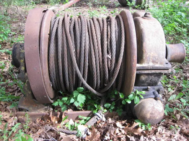

Hi Deas, Thanks for the info and help. It was used in a factory as a winch tractor with a draw bar added out the front to tie the tractor off, then the line off the winch run through snatch blocks to what ever they were moving or picking. It was my first cat it ran good everything else worked good the u/c was in good shape, seemed like a good little project and still does, after all if it was easy whats the challenge 😉 I was excited about it and missed a few things.

That's to bad....drawbar out the front probably put wrong leverage on the bolt pad.
Judging from the oil, I'd suspect the housing is cracked also. It's a big job but I think the only way it would be right again is to swap out the case......or transfer the good parts to another tractor which you are apparently considering.

Ooooppss! I thought you meant the bolts on the back of the steering clutch case that carry the drawbar swing frame. Ye Gods and little fish-hooks, they must have had some strain on something to do that. And I don't think Swishy's standard reply of, "It'll buff right out", has any application this time.
I think I'm with the wise old man who lives up on the hill at Corralitos on this one (Usually am in agreement with him anyway 'cos he's so wise). Swapping out the transmission case sounds like the best 'cure' for that ailment. I think I'd be checking both parts 5T's to see if either has water in the trans or any other bugs that might create more work than you need and go from there.
The dozer being on the second does lend some weight to choosing that one, especially if it is all there.
