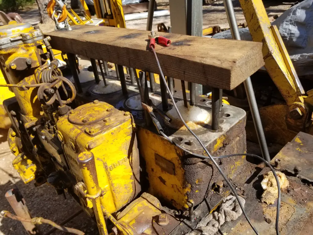

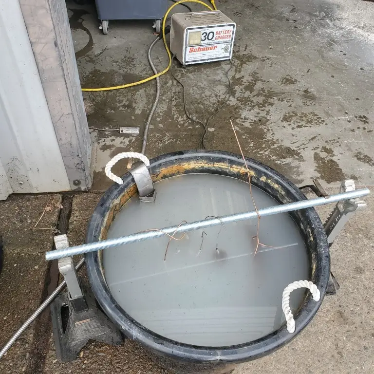

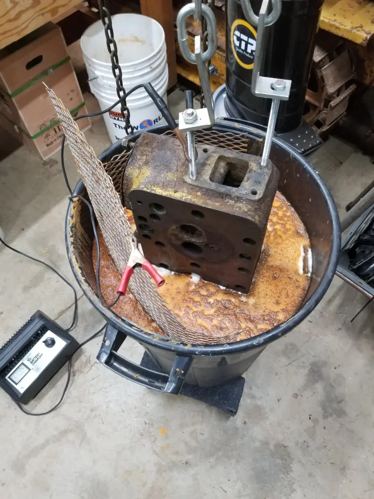

iowahill what is the liquid in the pot to boil the rust off? I have never seen that before, looks like plenty of items to keep you busy on the list of to do.

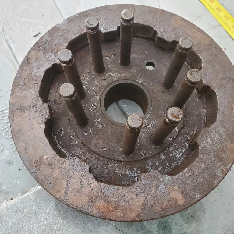

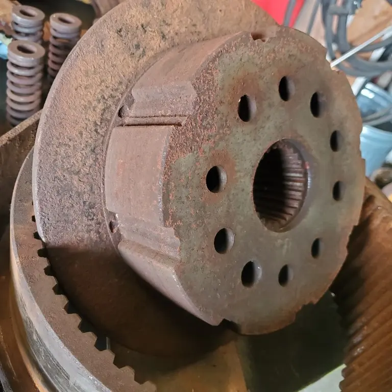

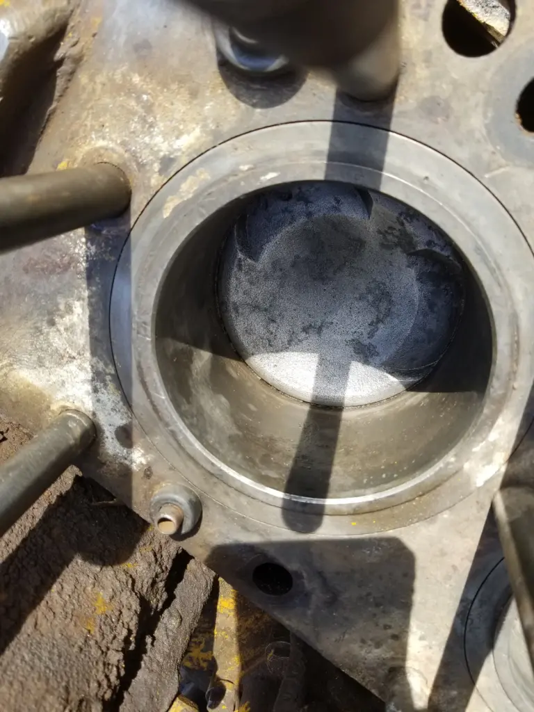

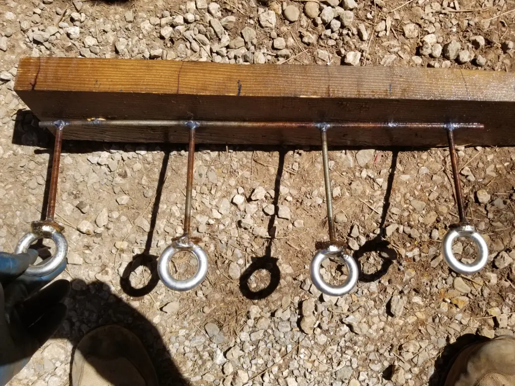

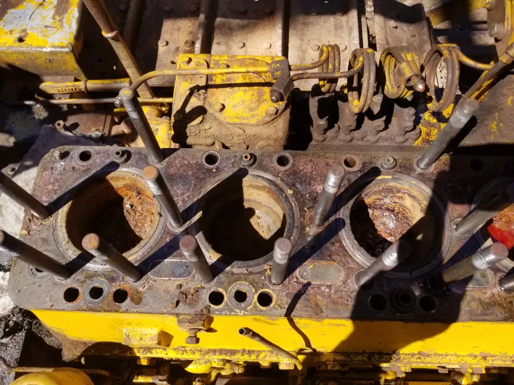

That pot of liquid is an electrolysis setup consisting of water, some washing soda and an old school (non electronic) battery charger. There are other methods and videos on YouTube.

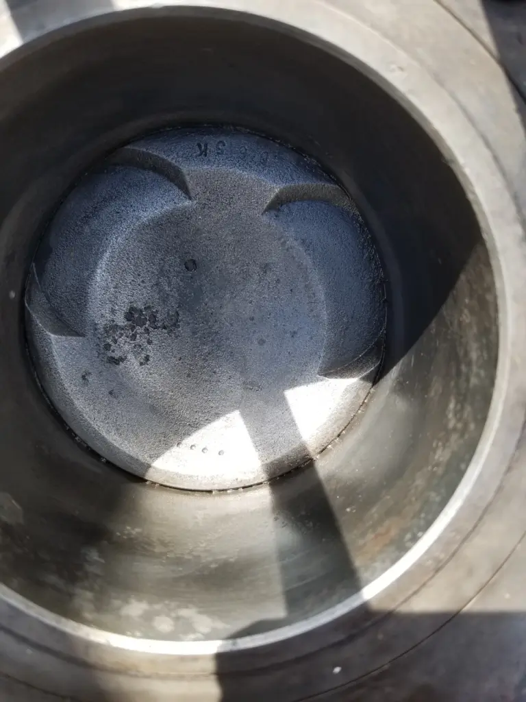

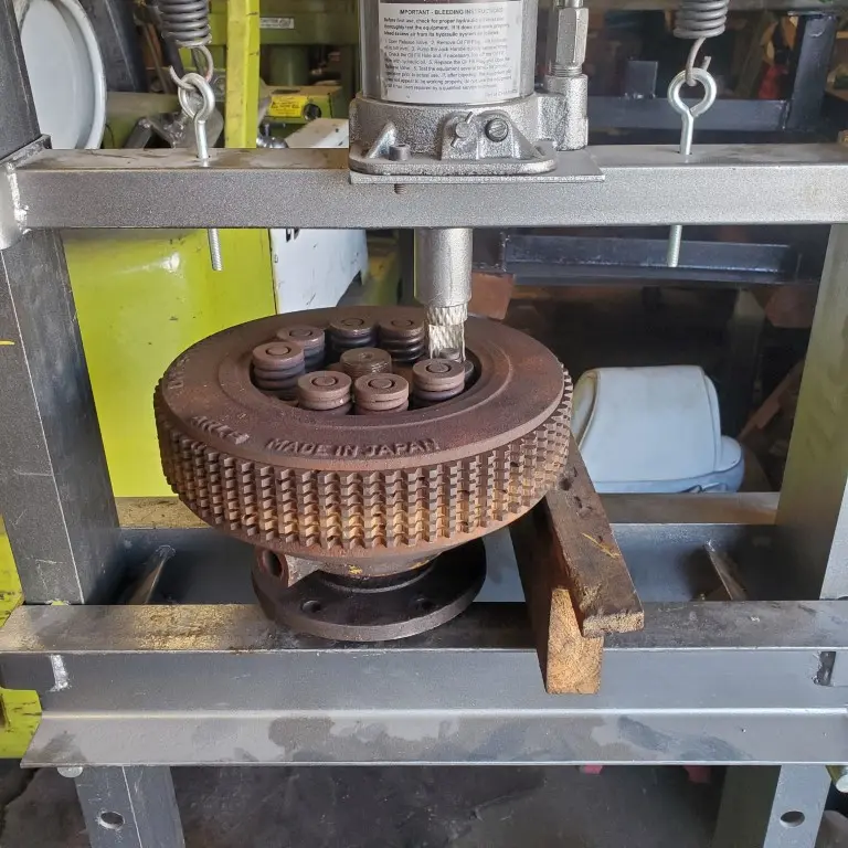

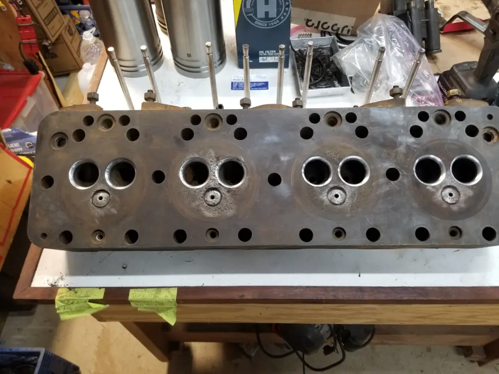

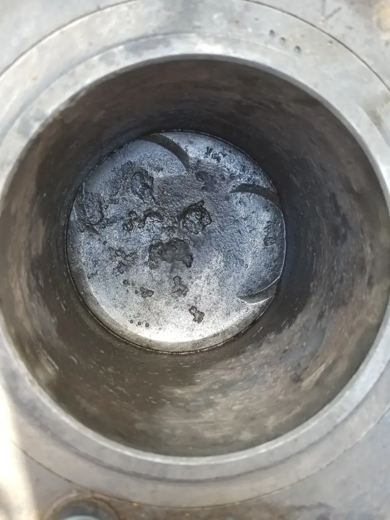

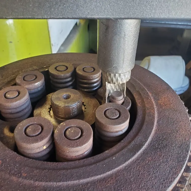

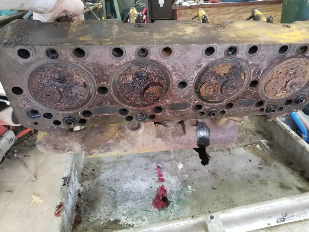

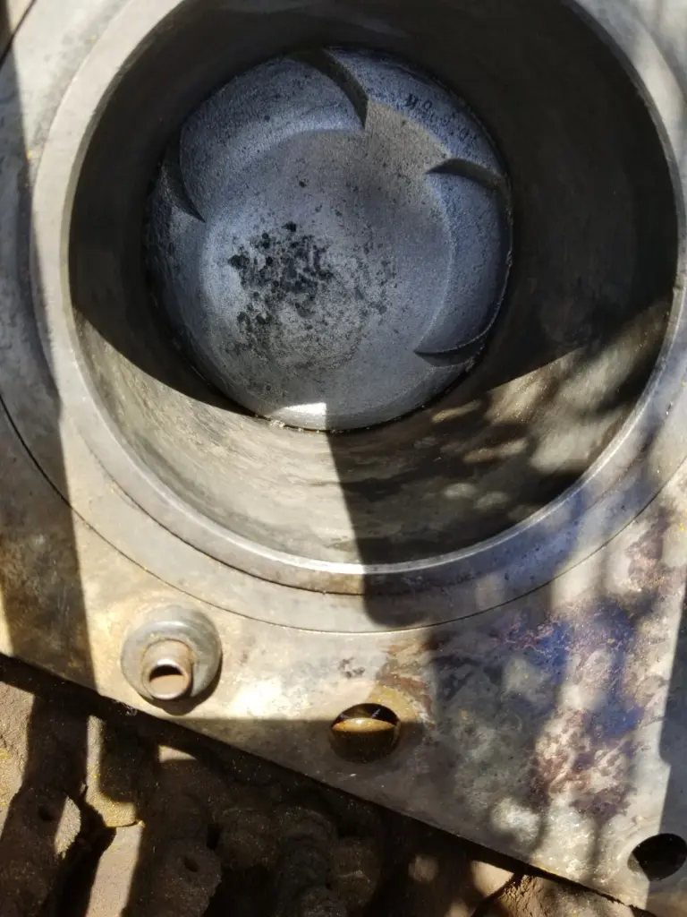

 I have used electrolysis with impressive results on many things. I managed to resurrect a D4 2T in the pictures below. All new liners a few rings to replace the broken ones and a valve job on the head, that's it and now she's a runner.
CrawlerAddict
 [attachment=77926]20240331_161025.jpg[/attachment] [attachment=77925]20240407_184656.jpg[/attachment] [attachment=77933]20240725_175548.jpg[/attachment] [attachment=77927]20240401_140440.jpg[/attachment] [attachment=77928]20240409_153015.jpg[/attachment] [attachment=77932]20240409_141956.jpg[/attachment] [attachment=77929]20240410_103252.jpg[/attachment] [attachment=77931]20240410_103259.jpg[/attachment] [attachment=77934]20240410_103303.jpg[/attachment] [attachment=77935]20240410_103308.jpg[/attachment]

Certainly makes impressive results and I imagine a lot less time attacking the rust and scale by hand, nice work
It's a solution of washing soda/calcium carbonate or baking soda (Arm & Hammer brand in the detergent aisle of your market) and water.  12-volt battery or charger with negative lead connected to the work, and sacraficial scrap steel or iron somewhere else but not touching the work.  Google "electrolytic rust removal" and there are plenty of links for setup and process.  Here's an excerpt that pretty well sums it up:Electrolysis MaterialsPerform electrolysis in an area with plenty of ventilation since it releases small amounts of hydrogen and oxygen gasses, which could be flammable if they build up.To remove rust using electrolysis, you’ll need:[img]https://d7fcfvvxwoz9e.cloudfront.net/dom43635/wp-content/uploads/2010/12/how-use-electrolysis-2.jpg[/img]

The beauty of the process is that it gets into places such as splined hubs that are near impossible to get into with mechanical means.  Regards,  -Tom
