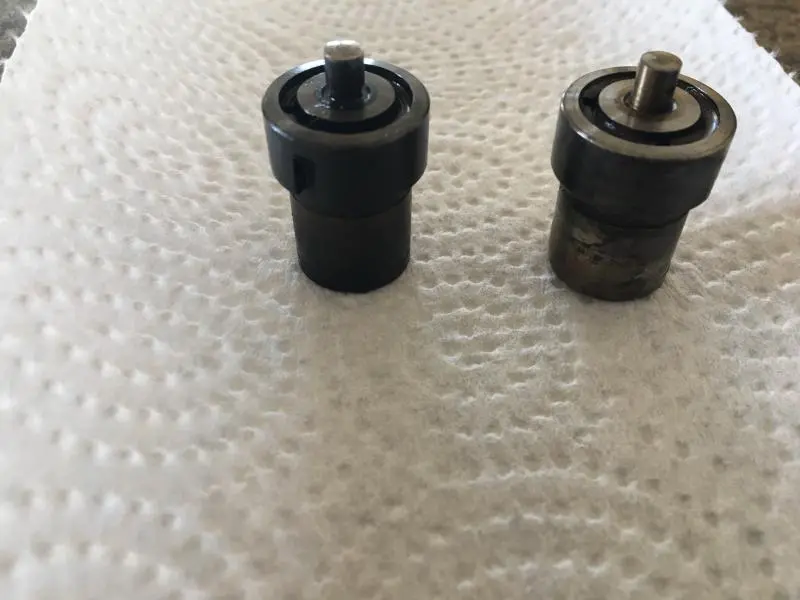

I’ve been working on my d4 lately and have problems with the injectors. I was wondering if 6B2854 is the correct part number for the valves and if the d2 and d4 have the same, as I would like to replace this part on my d2 as well. I’ve been having trouble finding this information on the search parts of the forum. Thanks!

My local cat dealer said that was the part number for the entire injector, I’m only looking for the part shown in the picture thanks.
Picture didn’t attach...

That is the valve service group 6B0914
Same as used in the 6B2845 (D4400) and the 2A5750 (D3400)
Not the same as used on other D4400 and D3400 injectors.
