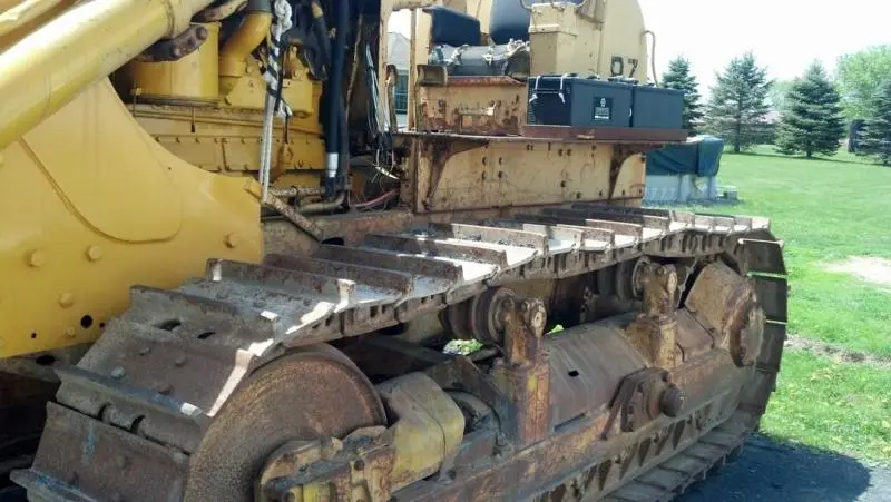

[attachment=23403]D7 RES.jpg[/attachment] Old Magnet, I am only going by description as I did not want to start it until I had a better understanding of the engine. What I know now (with much thanks to you folks here) is that it can not be anything to do with the decomp assembly but maybe a stuck valve, lifter issue or injector/timing. Once that is solved then a pressure test can be done to help trouble shoot the converter issue. It all may be simple (nothing every really works that way) and readily fixed. I myself have a bad back and can not "steadily" work or lift heavy parts any longer so am slow and must pay for help. Hate to admit it but that's my reality. It seems like it is priced right so someone can get it going but I am looking to use it in short order.
Thanks again, this is a great place for Cat knowledge.
