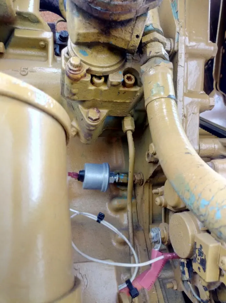

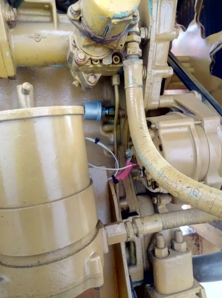

D333 23C698 4.75" bore powered generator. Works beautiful, took it up to 90-95% load going perfect clean exhaust too. Anyway noticed the drain tube originating from the fuel pump was dripping/running diesel so I guess it's time to pull something apart, i'm guessing going to need to replace some seals possibly?
See drain tube in question:
[attachment=57929]d3331.jpg[/attachment]
[attachment=57930]d333.jpg[/attachment]

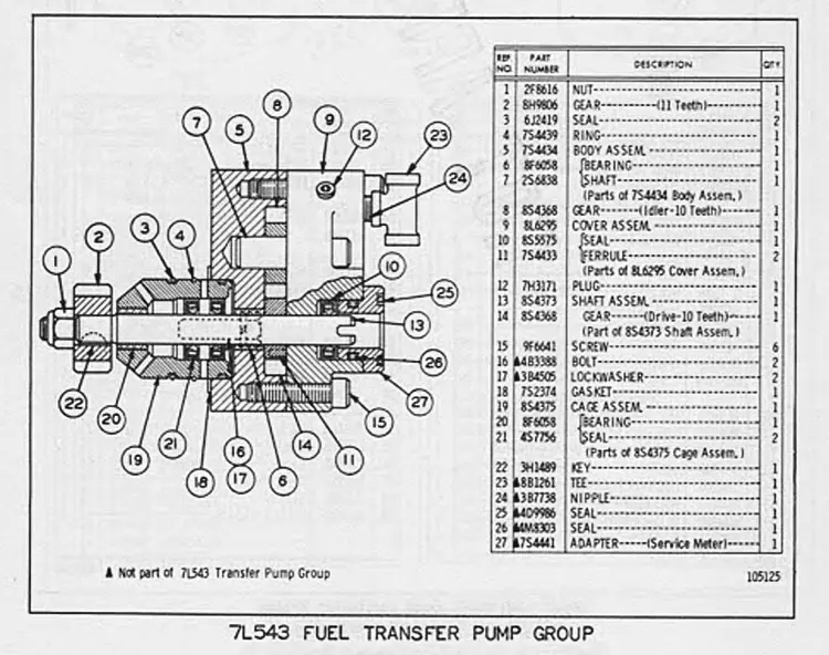

Yes, leaking from the seal cavity between the two 4S7756 seals and you will also need a 7S2374 gasket. Plus a few more...
