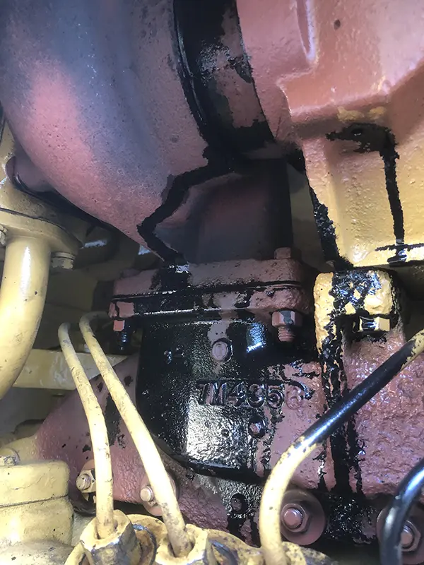

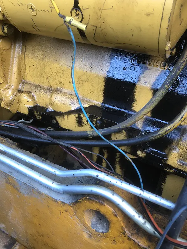

Thanks for the reply. The leak has gotten worse although the engine still runs the same. I am hoping it is because the engine has been doing a lot of idling while I have been positioning house frame panels. The oil on the side of the engine, I assume is coming from the exhaust side due to the blackness of the oil but 2 weeks ago I had the intake off to check the head bolt tension and there was oil in the intake after the turbo.
It is interesting your comment about the intake vacuum as this has the original 944 air cleaner. The later model 944 had the same air cleaner as the 950.
[attachment=60526]Turbo Leak 01.jpg[/attachment] [attachment=60527]Turbo Leak 02.jpg[/attachment]

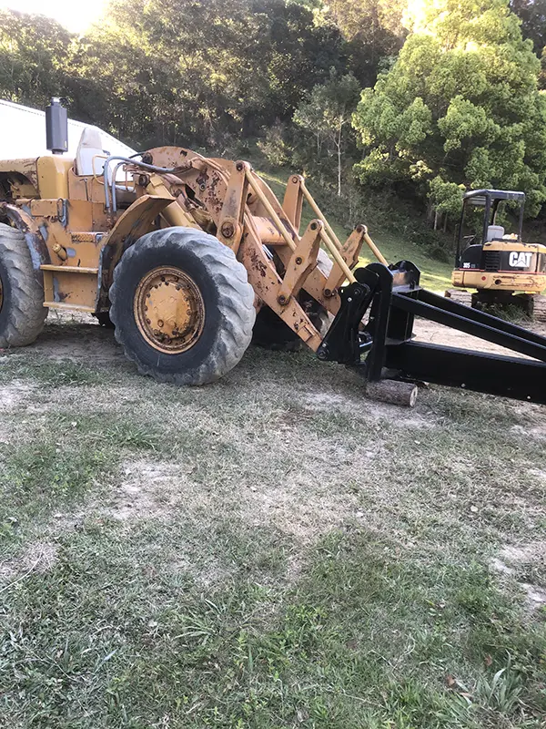

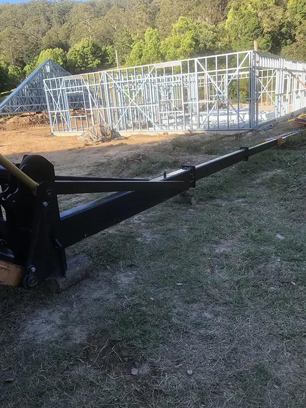

Here is the Jib I built for lifting the frames into position. Includes a 10ft fly jib.
[attachment=60525]Jib 01.jpg[/attachment] [attachment=60524]Jib 02.jpg[/attachment]

That's a very professional looking crane jib you have there.
I'm not familiar with that type of house construction, presumably the panels bolt together. What are they clad with on the outside and inside ?
It must make for a very rapid completion time.

Reply to gauntjoh:
Hi Phil,
Hello Gauntjoh
The panels are made of rolled sheet metal to form metal studs etc. They are very quick to put together and to lift into position. Normally they are supplied assembled but I got mine in a big flat pack.
Normal cladding with whatever you like can be used. I will be using fiber cement boards on the outside and drywall on the inside.
The biggest selling point for me is "Termite Proof".
