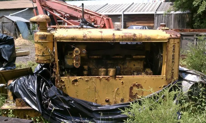

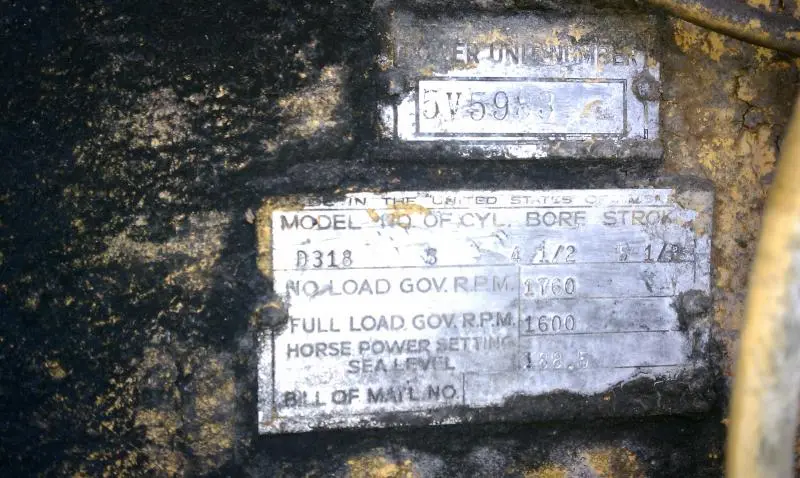

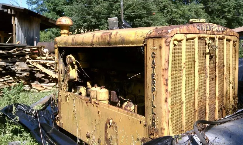

Hello: I am a new member to this club and I am about to take possesion of this D318 power unit that came off an old retired sawmill some years ago. I am going to use it to power my Frick 00 sawmill which is currently powered (underpowered) by a Ford BSD 444. I am expecting to have plenty of power to spare... I am hoping somebody here knows the year of serial number 5v5983. The name plate says full load governed rpm is 1600, which, if I don't change any pulley sizes will give me close to the right blade speed. Any thoughts on whether to try to slow down the motor with a bigger drive pulley? Can anyone recommend a source for manuals. I'd love to see the torque curve for this motor... Thanks

Year built is 1948.
Plenty of range with the D318...anywhere from 1000 to 1800 rpm is good.

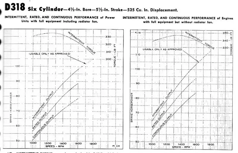

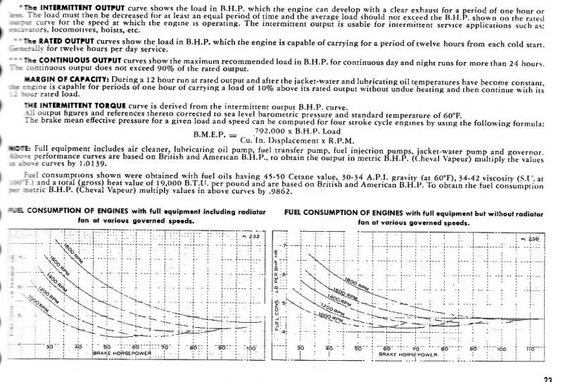

Hi Team,
hope these are better.

Thanks edb, that I can read......

Thank you for the info. I am more excited than ever to get this thing belted to the saw... I am supposed to pick the thing up this Friday.
What I read from these hp/torque curves is that Cat did not dino test these motors, but had their designers who used God-knows-what critical parameters to calculate allowable load hp/torques. I would be willing to bet that a dino test of this motor would much yield much higher hp than the name plate.
Should I go to ebay for the service manuals? Happy tracks.

[quote="snakeknuckles"]
What I read from these hp/torque curves is that Cat did not dino test these motors, but had their designers who used God-knows-what critical parameters to calculate allowable load hp/torques. I would be willing to bet that a dino test of this motor would much yield much higher hp than the name plate. [/quote]
Don't know how you can assume that-of course Cat had access to dynamometers-they are not new technology by any means...the Prony brake was used to test steam engines..a HP-torque curve just pulled out of some engineer's ass would be false advertising...
